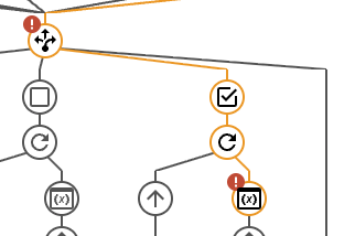

Error: ZeroDivisionError: float division by zero
I have two RF remote ceiling fans controlled by the Bond Bridge. They work fine from Home Assistant. The Bond Bridge sets the speed via percentage, but the HA cards show preset buttons.
This blueprint only works for me in Three Speed Fan Mode and then, it only turns the fan on or off at the last speed (since there aren’t selectable entities for each speed). I’ve updated to 2.0 with no changes.
Enabling Fan Percentage in the automation always results in a ZeroDivisionError and it happens on the last decision step, then again in the Percentage Fan section.
What setting is causing this? (The temperatures are test values I was using and not indicative of reality.)
Thanks in advance!

@jcreagerlv
Your using a device in Fan Controlled By A Percentage Value you can only use entity. This is a link to a FAQ of my sensor light blueprint but it shows you how to expand down to an entity click here
Blacky :grinning:
Thank you. Just now noticed the reply and updated the settings. I must have added this right after I got the Bond Bridge since that’s what I was trying to control.
The fan now ramps up and down based on the local temp and an Enable helper. Huzzah!
