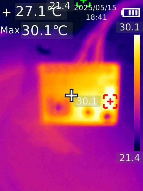

I have a combo ENS160 + AHT2X, purchased from cheap AliExpress supplier and can confirm the AHT2X measurement is useless. It reads >5 DegC too high when the ENS160 is enabled and >1 DegC too high with ENS160 disabled. The ground backplane on the board just equalises the heat from all components, even with the AHT2X out on a little island.

The ENS160 datasheet explains why it gets warm. This is completely normal, the gas sensors are heated internally in order for them to function.

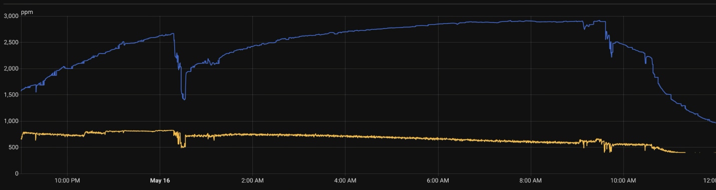

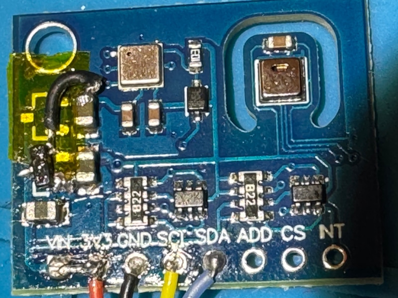

  1. Heat mostly from linear (both, even I provide 3.3v only).
  2. Values not so good as specialized co2 device (orange is ENS160+AHT21)
  3. I did some changes to improve temp values: removed 3.3v stab and moved 1.8v further from AHT plus use some capton tape to separate it from pcb.
