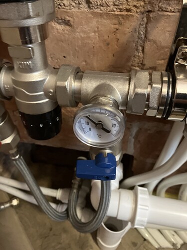

I’m trying include our new underfloor heating in our home automation. I’ve got the valves and pump working. I am now looking for a way to monitor the inlet and return water temperatures.
I have 6-8mm dumb temperature gauges in “dry holes”, and trying to find a smart equivalent. I’d prefer zigbee, but honestly anything and I have mains power available if needed.
Any suggestions much appreciated!

It’s a bimetallic analog gauge.

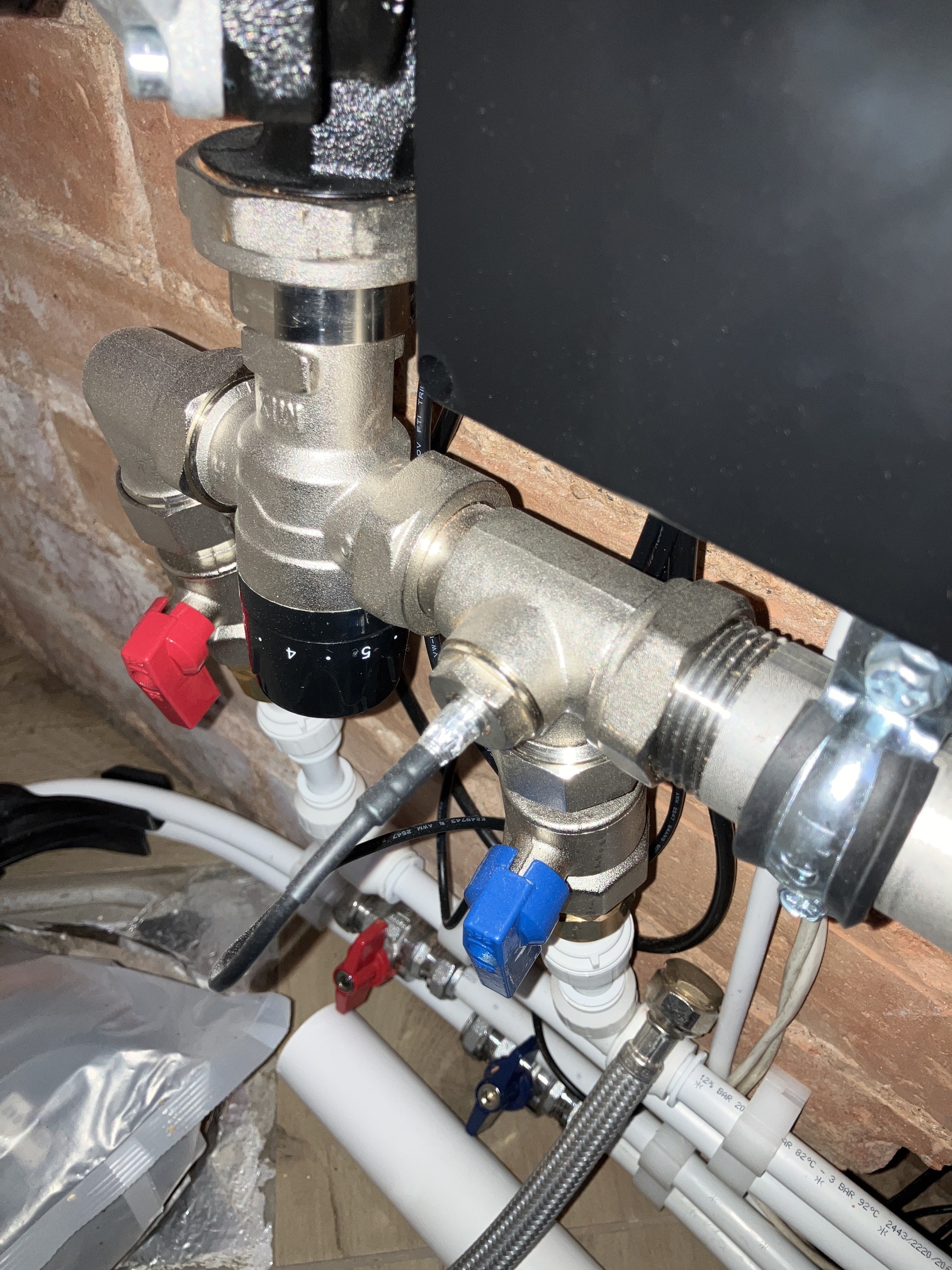

In my case, I attached the sensors straight to the outside of the pipe (metal) and insulated it with foam (to the surrounding),
I have. I’ve wrapped extra aluminum tape around the sensors to get them up to the same diameter as the original analogue gauges.
Then using the Shelly plus to read them.
I have an extra one using a pipe clip on the hot inlet just to check the thermostatic valve is working.
I’m super impressed at how responsive they all are - much quicker than the analogue gauges.

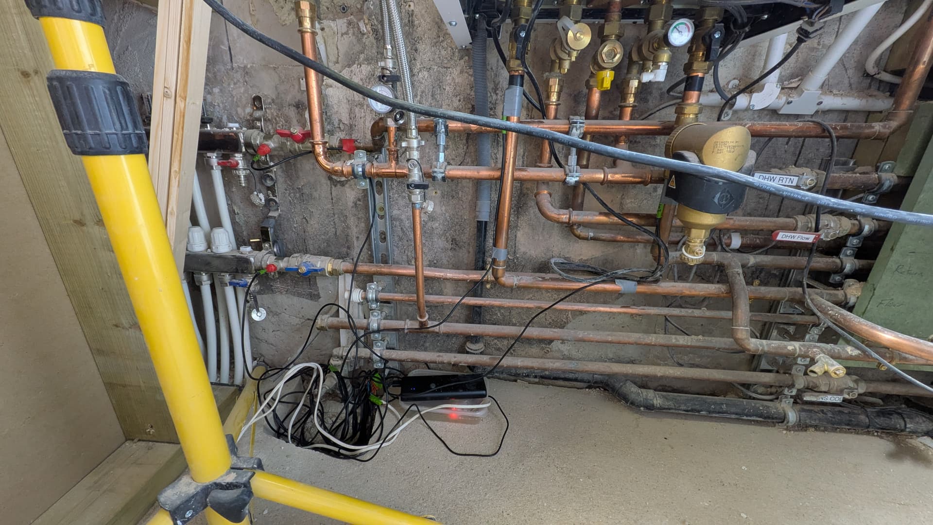

I’ve only got 3 sensors on the Shelly Plus, so far, but it’s working well.
I got four sensors hooked up. Two two the manifold and two to the boiler. The boiler gives me the flow for the manifold and the boiler and it’s a few degrees out but I can correct that with a calculated sensor after I’ve collected enough data to extrapolate from. Processing: 1000044821.png…
