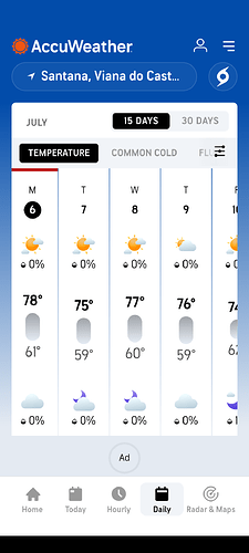

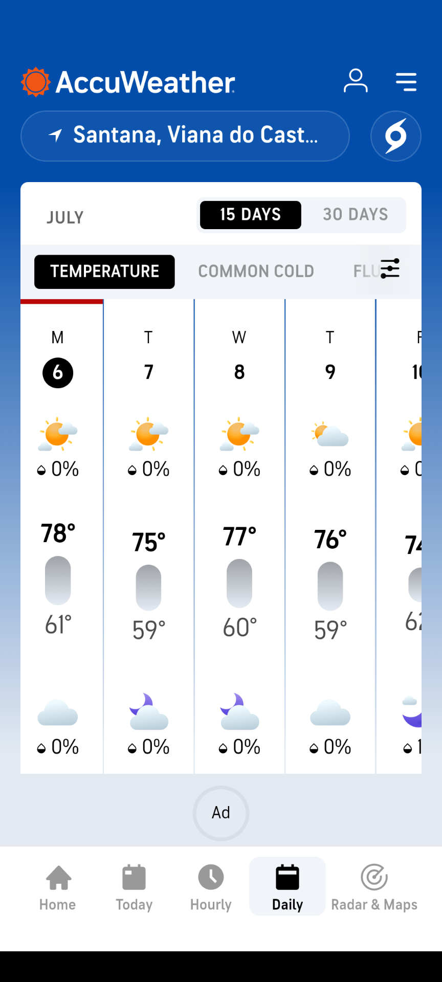

I checked the manual too before I bothered anyone. It's Sunday and I had time to set up an automation so was hoping someone else went through this and knew the answer. I will contact Husqvarna to see what they recommend. Our temperatures only got in 90's. These are our normal wonderful temperatures:

Normally our temperatures are quite moderate here so we don't need to hide inside midday. This week:

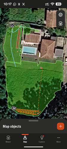

I would guess the largest incline is around 30 - 35 degrees. Our total mowing area divided into 1 large and two small areas is a little over .6 acres. I have to mention that the yard was not maintained at all before we moved in. There are a multitude of heavy clumps of weed grass all over that the robot has a tendency to get stuck on. I am gradually digging them out and evening the surface.
Here is a map of the three areas.
The small area at the top took a total of around between 45 and 90 minutes. The medium area took around 5 hours.

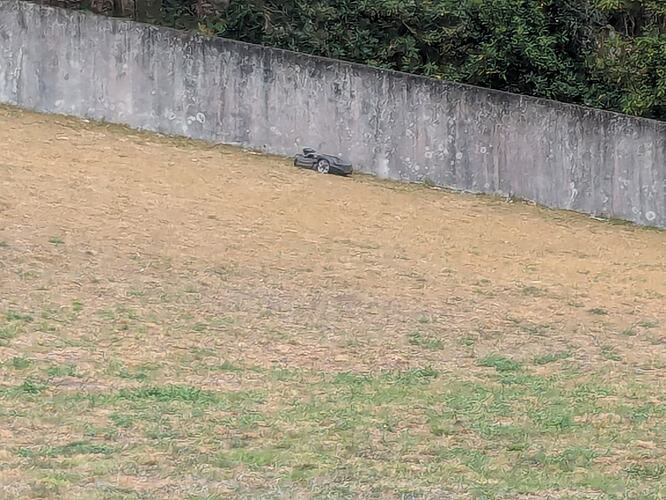

Here is a photo of the robot on a lesser than max incline.
