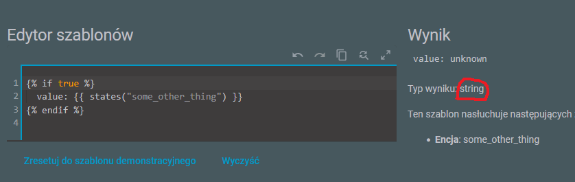

This:
produces a string. You can help yourself by testing such code snippets in the template editor in Developer Tools and observing the type of result.

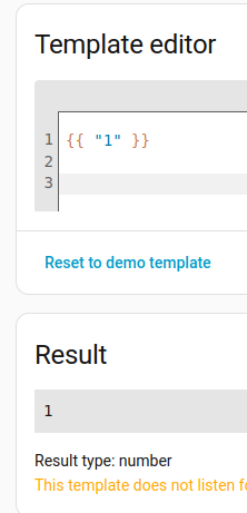

I am, of course, aware of the template editor (been using it for years).
However, until now I was not consciously aware that it shows the data type of the output.
Thanks for pointing that out!
…with some caveats about its behaviour:
