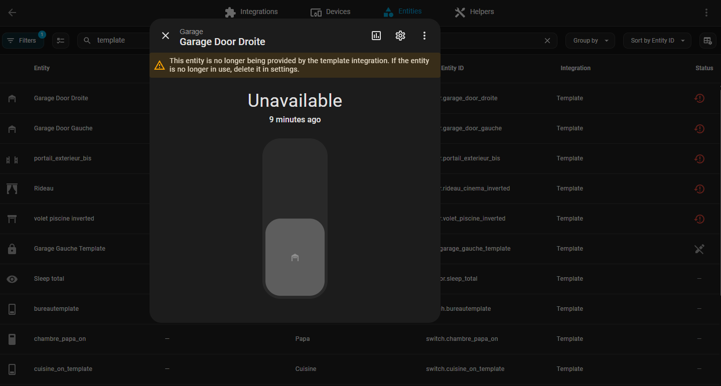

Template - Cover: migration - entity is no longer being provided by the template integration
I’ve been trying to update my config.yaml’s templates to the new version.
But I get the following error for all my covers, yet my lock and switches work.
What is wrong in my yaml?

I’ve narrowed down the issue:
This template (and the one after) do not work anymore: what is the correct syntax now?

Please see the pinned topic here for help: Deprecation of legacy template entities in 2025.12
Also here is a custom Integration to convert them for you if that doesn’t work for you.
Comment there if you need more help.
I commented on the post you mentionned… thx
