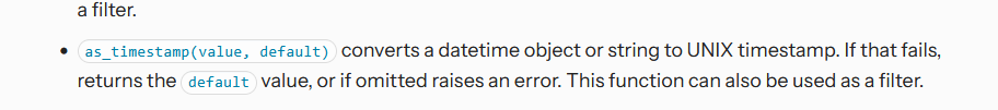

I replaced your template with ... so you can fully see the entire error message.
Why are you making your attribute a list-shaped strings instead of just using an actual list…?
Do you really want a character/letter count for the value of device_list_length?
Thanks for pointing me to the obvious! Somehow I did not see the tree as the forrest was in the way. :sweat_smile:
Moral of the story: Do not just cut and paste something one finds on the internet assuming it works like charm. :sweat_smile:
