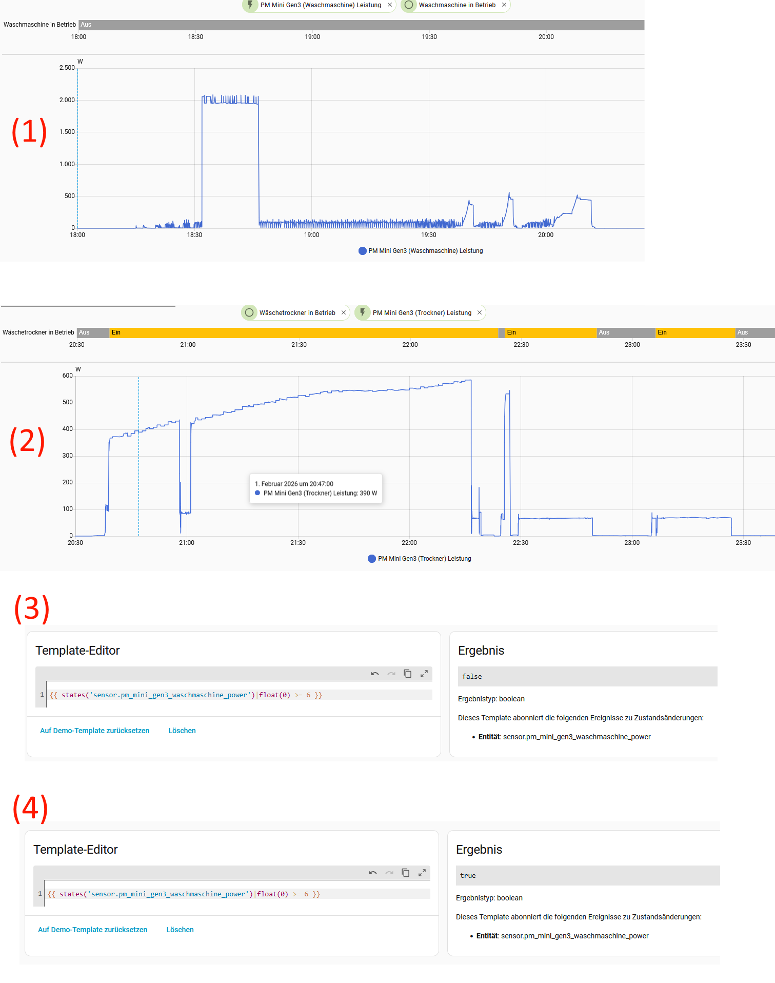

Both sensors are added to HA as expected. However, the one for the washing machine does not update. For an example, see attached chart (1).
The “Waschmaschine in Betrieb” sensor never updates, even though the template condition is clearly met. I also evaluated the template in the developer tools, and it seems to be working fine. For example:
While the washing machine is off: see attached chart (3).
And while the washing machine is running: see attached chart (4).
The binary sensor for the tumble dryer is working fine: see attached chart (2).

As I can add only one media attachment, all pictures in one:
