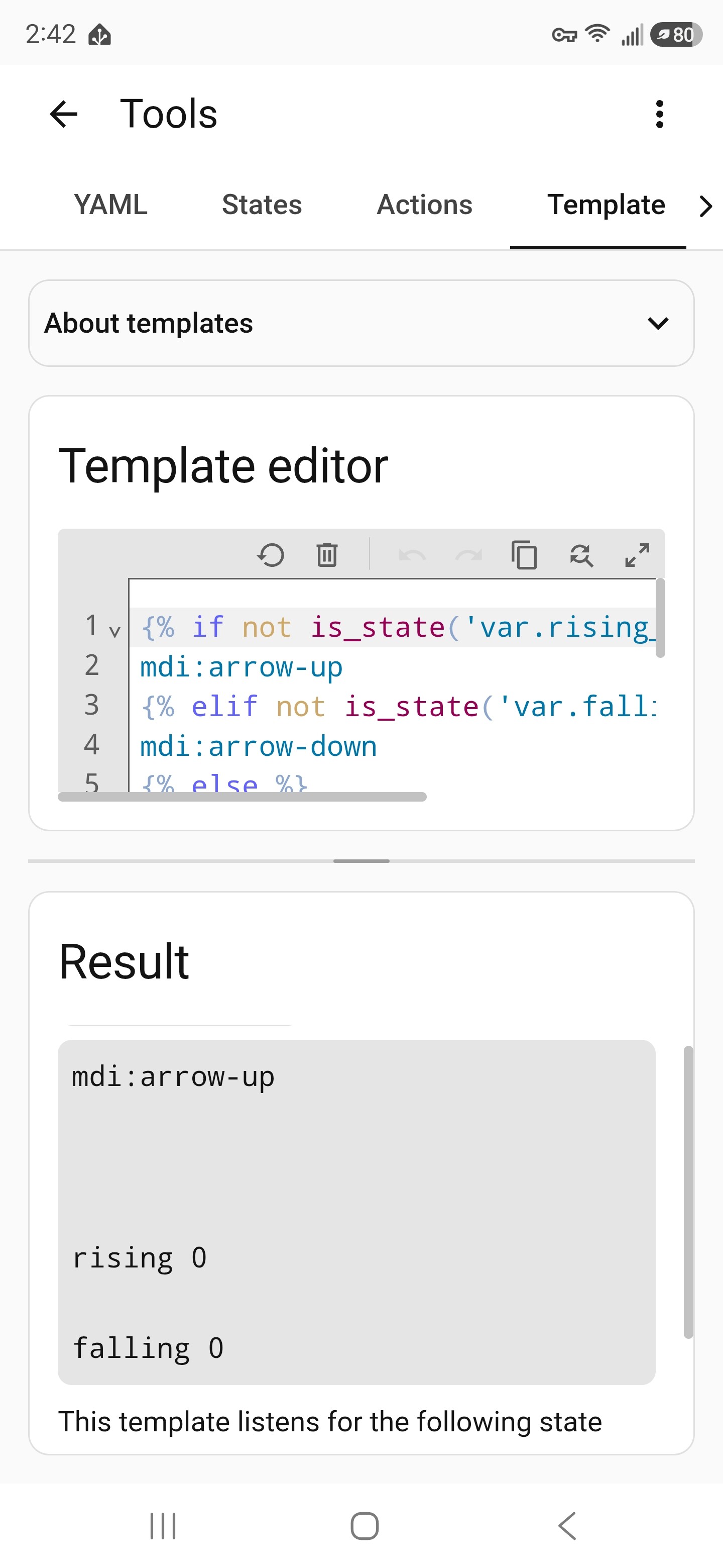

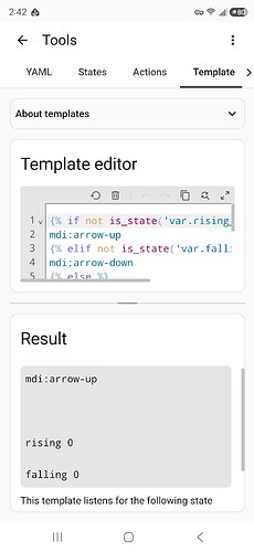

The following template uses the numerical variables and additionally I have extracted the variable states as a test method. A screen capture shows the results.

{%set tup = states('var.rising_temp_active') %}
rising {{ tup }}
{%set tdn = states('var.falling_temp_active') %}
falling {{ tdn }}
