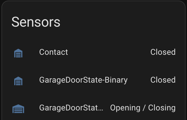

need some help getting a cover template working.
I have an athom tech garage door opener with the reed switch configured at the open end of the door. I have a reed switch for when the door is closed connected through my Konnected alarm panel.
I want to combine these two sensors to have a Garage door state Closed, Open, Opening/Closing. I have the code I am using in my binary sensor template configured through the front end below. The state remains as “Closed” even when the sensor states dictate an “open” state. Any thoughts?

Thanks for the help but it still isn’t working. I tried creating a sensor rather than a binary sensor (maybe because theres more than one option?) and It seemed to work. As I haven’t got the alarm reed switch set up so its currently open.
