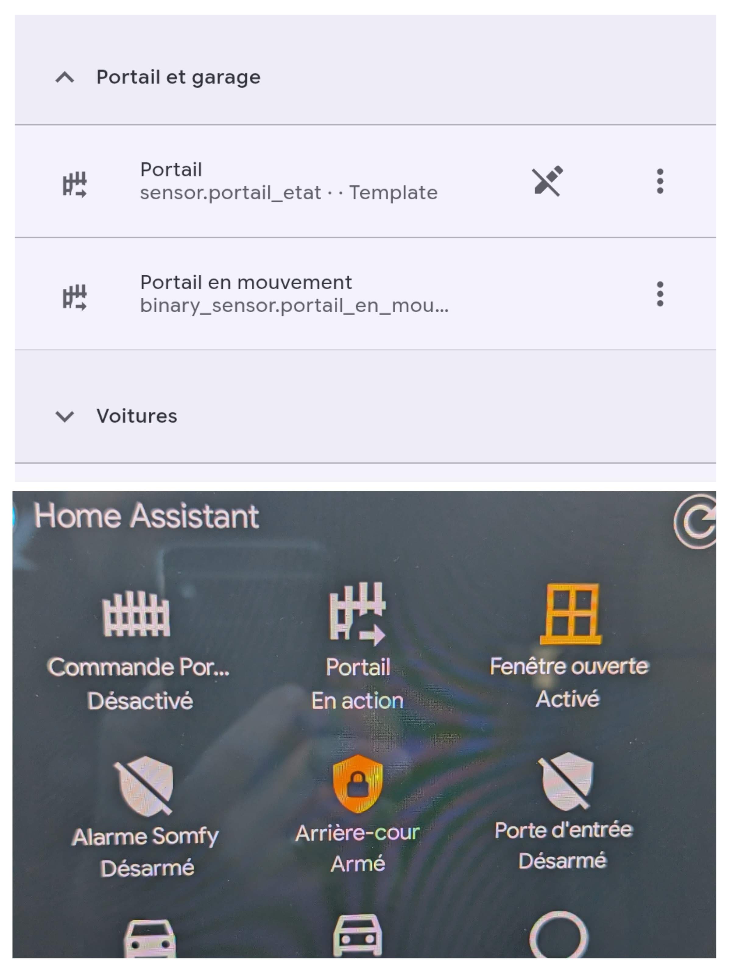

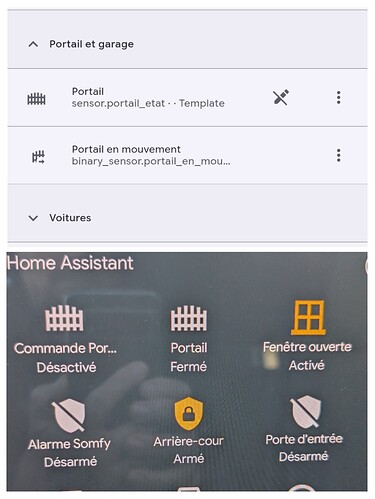

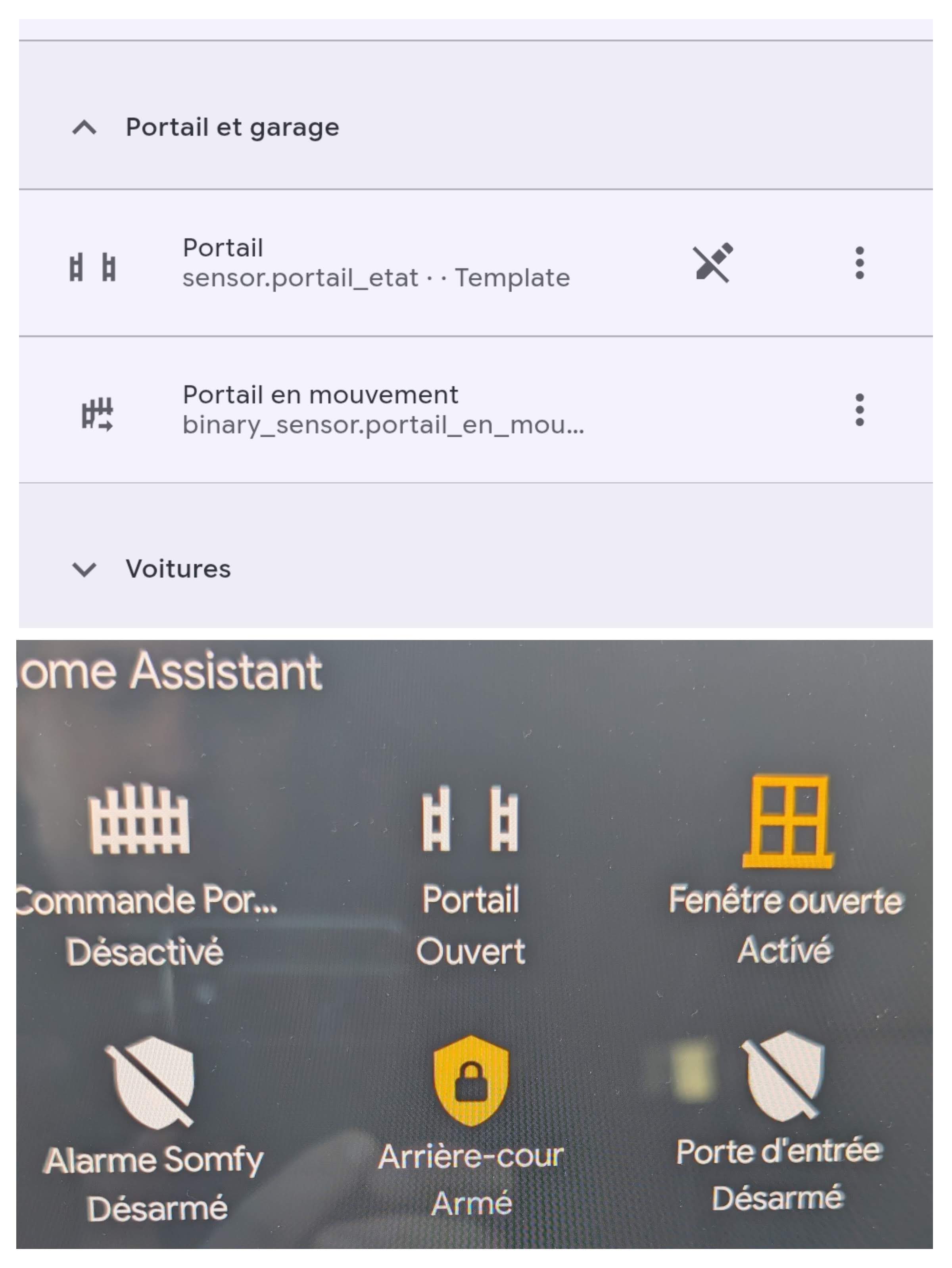

Both in the frontend and in the android auto screen, the sensor icon is shown as black/white whatever the state of the sensor. How to make it display as default “active state color” when opened or moving like the alarm or window icons visible in the AA screens below and only keep inactive “black/grey/white” color when closed? So that I can get a quick glance of the gate’s state when driving?
In the HA frontend I’m using the custom-card mod to switch color between grey/white when closed, yellow when moving and red when opened. But I can’t find a way to set the color to “active” for the entity when its state is not “closed”.

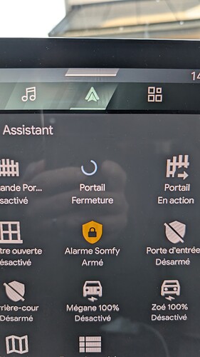

There is still an issue when using the “cover” method in Android Auto app: when the gate is opening or closing the icon of the entity becomes a turning circle and I can’t click on it anymore; hence I can’t stop the gate and have to wait for it to be fully open or close.
