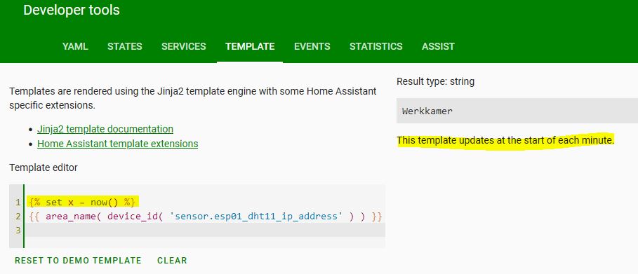

Just as a test I added now() like this to the template:
And indeed the template is updated now every minute, so in fact like this a time pattern trigger is added to the template.
