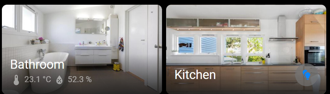

Can’t get my temperature from my Mill heater in the area card.
From my climate I’ve created a template sensor and sat it to the correct area… but It will not show up.

Add this to the Template Sensor’s configuration and see if that makes the Area card display it.
device_class: temperature
