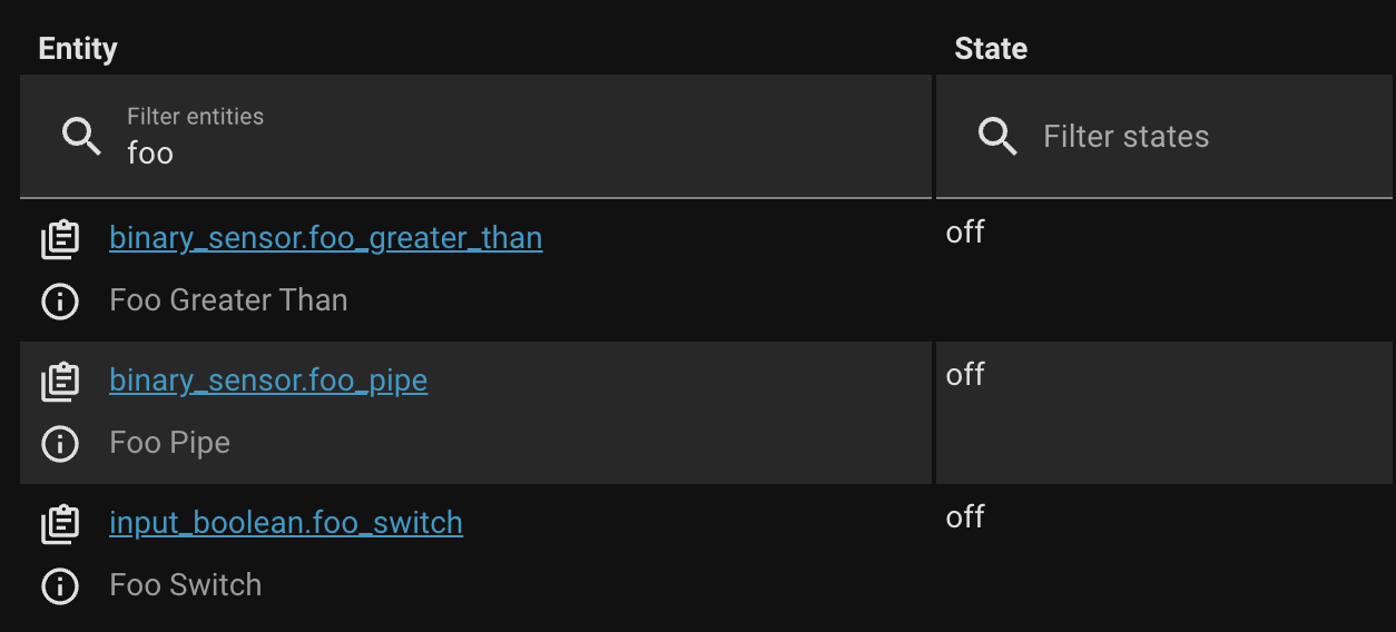

- binary_sensor:
  - name: "Foo Pipe"
    state: |-
      # this is true
      {{ is_state( 'input_boolean.foo_switch', 'on') }}
- binary_sensor:
  - name: "Foo Greater Than"
    state: >
      # this is true

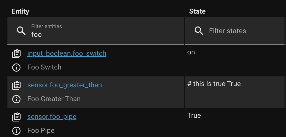

Not sure how it’s working for you as the code itself only looks for specific values and it does not strip characters:
If you turn them into sensors they return this, and notice the pipe one returns “True” or “False”, so that would match the code, right?
Debugged into it, the |- retains the carriage return between lines, e.g. # this is true\nTrue. The raw template passed to ast (a built in python lib) ends up transforming the result to True. There’s no telling why it does this because the underlying code is C++, not python and vs-code doesn’t allow me to step into it. This is likely a bug of some sort. As for some background ast is used by home assistant’s template helper, meaning this is very low level code handling this transformation. As a result, when the rendered value is provided to the template entity integration, all I see is True or False.
As for the > version, that should remain false and does remain false on my dev system. Carriage returns are stripped at replaced with white space, this preserves the comment and renders the entire string # this is true True. I.e. The template entity integration receives the value # this is true True or # this is true False which will always be treated as False because of the forgiving_boolean function.
