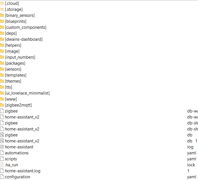

can you now post a screenshot of your config\templates directory?
And then post the contents of the very first file as yaml

But those files are not present in the template folder picture you took above…
1 file:
no, because they weren’t functional, I copied them to my NB.
I always leave only functional files in the directories§
Well everything is set up correctly based on what you’re saying. So it’s anybodies guess why it’s not working for you.
You can look at my configuration and see how I have things configured. It’s basically identical to your setup.
