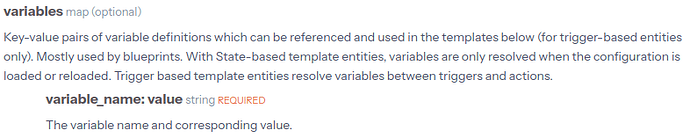

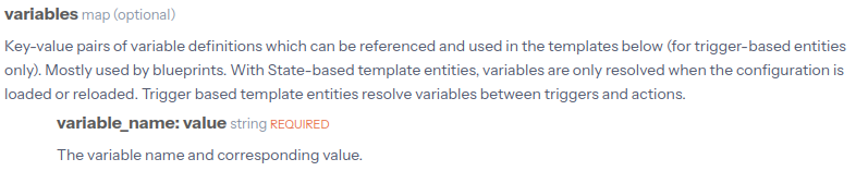

variables is one of several options that are common to all types of Template entities.

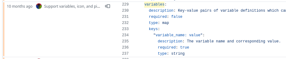

According to Home Assistant’s Github Documentation repository, petro updated the documentation 10 months ago (concerning variables, etc).
It implies the variables option has been available for several months. Having said that, I tested my example using 2026.4.0.
A couple restarts and the error went away and it started calling the service to turn on/off. However I’m seeing a delay there as well. I know you said you do not get that.

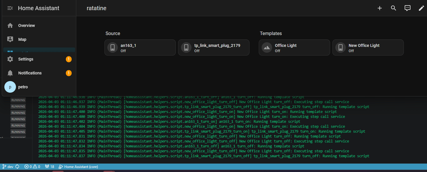

Here’s a video to show it in action. https://youtu.be/w9lwof42Bmw I created a single page with all three sensors (old switch, new template switch, and the variable example above) as well as both devices. I also put up a tail of the log as well as the template rendered under dev tools.
You can see:
  • (Well you can’t see this but) the lights are turning on and off with the associated devices.
  • The template renders immediately when I turn on and off the old switch template.
  • Both the new template switch and the variable based one are delayed.
  • Both devices turn on and off immediately.
  • Only the new devices are flip-flopping.
  • The log shows exactly when they update properly and it’s when the Trigger Update Coordinator logs.
I did update to 2026.4 though that didn’t change anything in this behavior. I’m game to try any suggestions but right now the new hotness isn’t getting me there for some reason. If there are other state templates I should try I’m happy to do so but I’m at a loss for what. Maybe try “on/off” instead of “true/false”?
