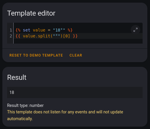

Jinja templates use 0 as the index for the first item in a list, not 1.
You could also just use replace:
{{ value.replace("°","") }}

Make sure you have the right symbol,there are like 3 that are very similar but different codes.
{{ value|select('in','-.0123456789')|join }}
will remove anything that’s not part of a number.
