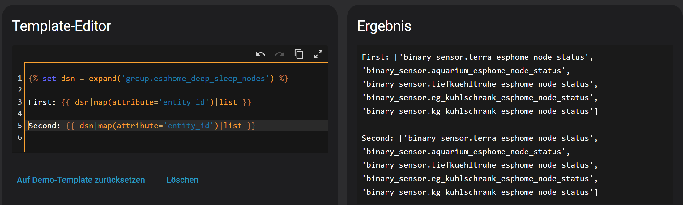

Template variables forgetting their values...?

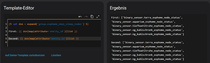

This template…
… seems to work as expected.
But this template…
…umm… doesn’t…?
How is that supposed to happen?

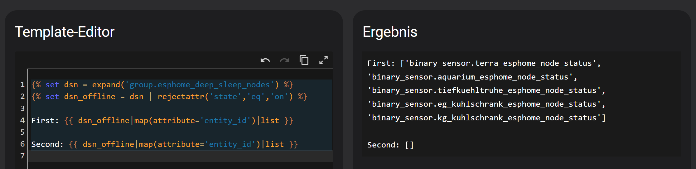

No, refreshing the browser isn’t changing anything.
I only showed this in the template editor, because it’s convenient to capture the template together with the result in a screenshot.
The template is behaving the same way in a template sensor rendered in the backend.

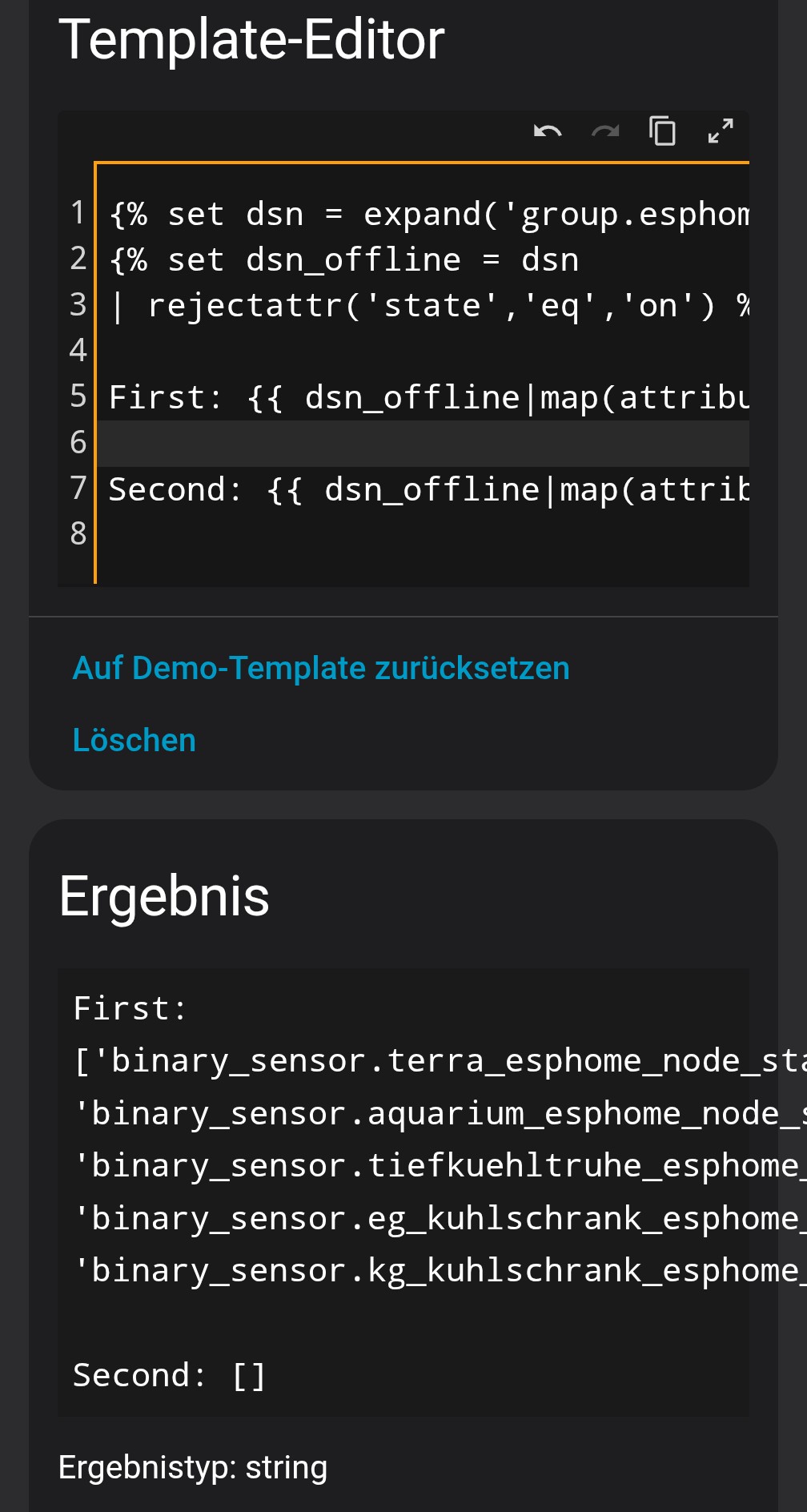

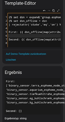

I can reproduce this after a browser refresh, after deleting all cached data, in a private tab and even on devices, where that template was never used before. This is a screenshot from my phone:

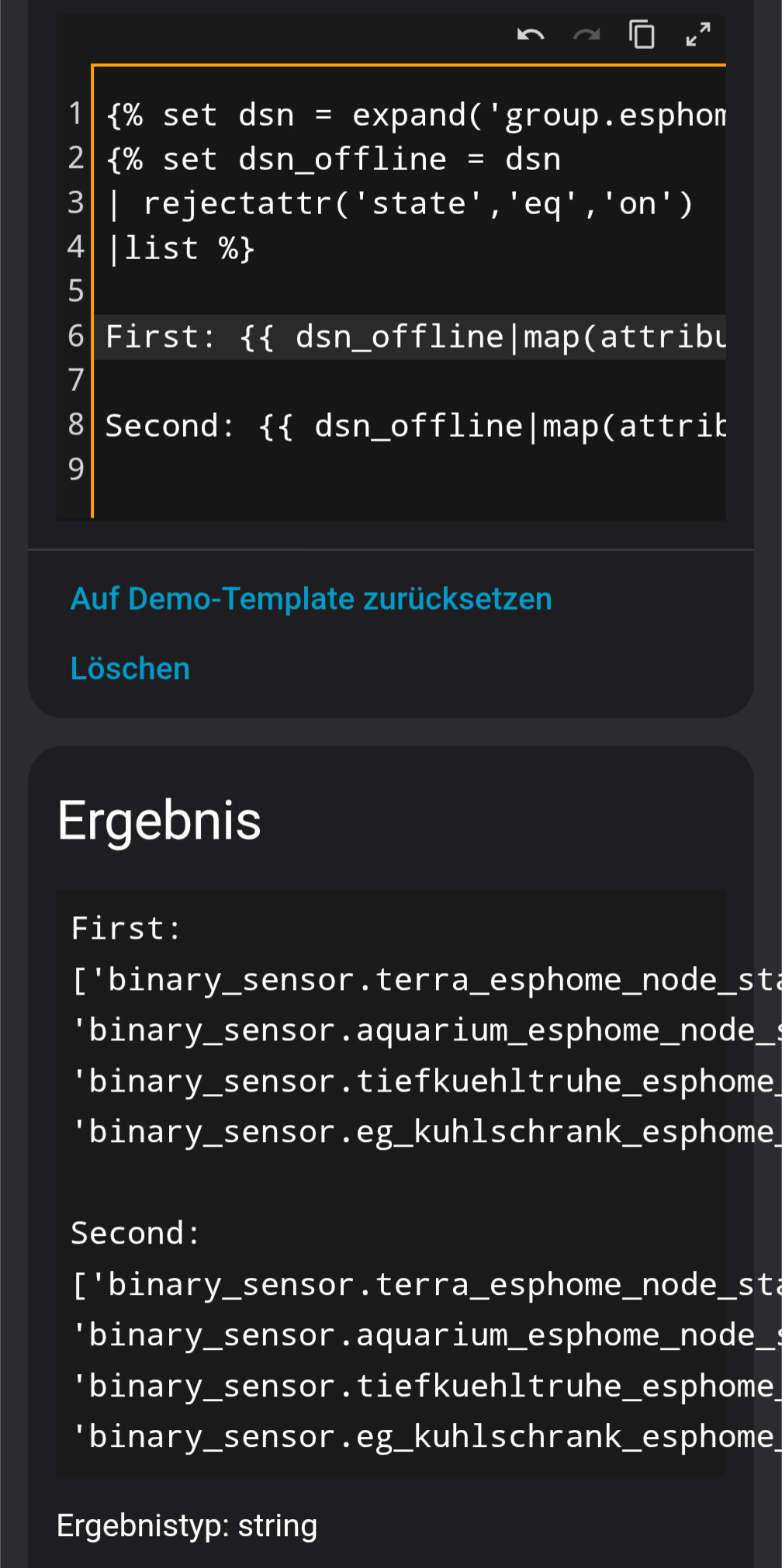

How does it behave if you explicitly cast the variable as a list?
{% set dsn_offline = dsn | rejectattr('state', 'eq', 'on') | list %}
In this case it’s working fine. Interesting…
This seems to be the solution, although I still don’t know, why the output of a reject filter can’t be directly saved in a template variable, but has to be cast explicitly to a list.
In the template editor, the output of a select/reject is declared as <generator object select_or_reject at 0xabcd...>. Maybe a “generator object” is a pointer only meant to be read once by the next operation (i.e. the next filter) and discarded afterwards?
It’s a generator. It’s an object that only allows you to iterate once and it’s built for speed and optimization. The code only “handles” the objects you access, unlike a list where everything is loaded/handled.
