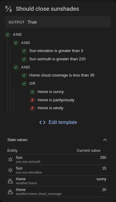

Hi guys! I just wanted to share a custom card I made for myself, but thought maybe others also might find useful :grinning_face_with_smiling_eyes: its a template visualizer card. My use case was debugging a template sensor that triggers automatic shutters. It was a hassle not knowing why it did or didnt go when the template depends on multiple less obvious sensors and values, so i made this, it shows a visual representation of all the logic. If anyone is interested id love some feedback :heart:
