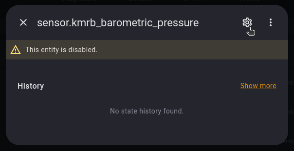

The NWS integration includes 11 sensor entities for current observed weather parameters. Does anyone know the syntax for how to trigger these to populate the entities?
Are you asking how to enable the entities?
In the Entities menu find the entity you want to enable and click it.
In the More Info pop-up, click the Settings menu button:
Click Enable:
I appreciate the response, but sorry, no. They’re all enabled.
