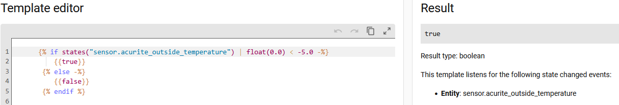

Hi, the following templated binary sensor:
  - default_entity_id: binary_sensor.low_temp
    state: >
      '{% if states("sensor.acurite_outside_temperature") | float(0.0) < -5.0 -%}
         {{true}}
       {% else -%}
         {{false}}
       {% endif %}'
isn’t working. Outside temperature is -16C so its value should be true, which is confirmed while running the template in the Developer Tools Template:

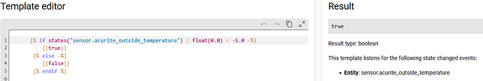

But the state of the sensor is false (off) as shown here:
Not sure what I’m doing wrong. Home Assistant was restarted and no errors are flagged when checking the configuration. Thanks.
Remove the quotes surrounding the template.
Only on single line templates on the same line as state: should you add quotes.
You used > and new line, that should not have quotes
Thanks! That was it. TIL. It also allowed me to figure out that hitting “All YAML configuration” is enough to reload templated entities in configuration.yaml. A full restart isn’t necessary.
