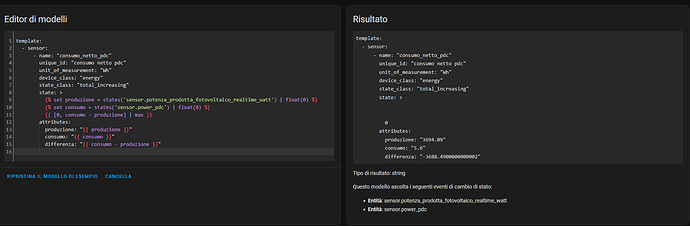

I've been losing my mind for days with the following templates:
every time I restart Home Assistant, the following errors appear; however, I see that the sensor is counting correctly:
I'm reporting the template code and the errors it reports below:

Hi, please next time put your yaml in a </> code block, this is impossible to read or check. But from what I can see: jinja variables you define when determining state do not carry over to the attributes. You have to define them there again.

thanks for the quick reply.
this is exactly what I can’t understand and solve.
I hope I formatted the yaml code correctly.
