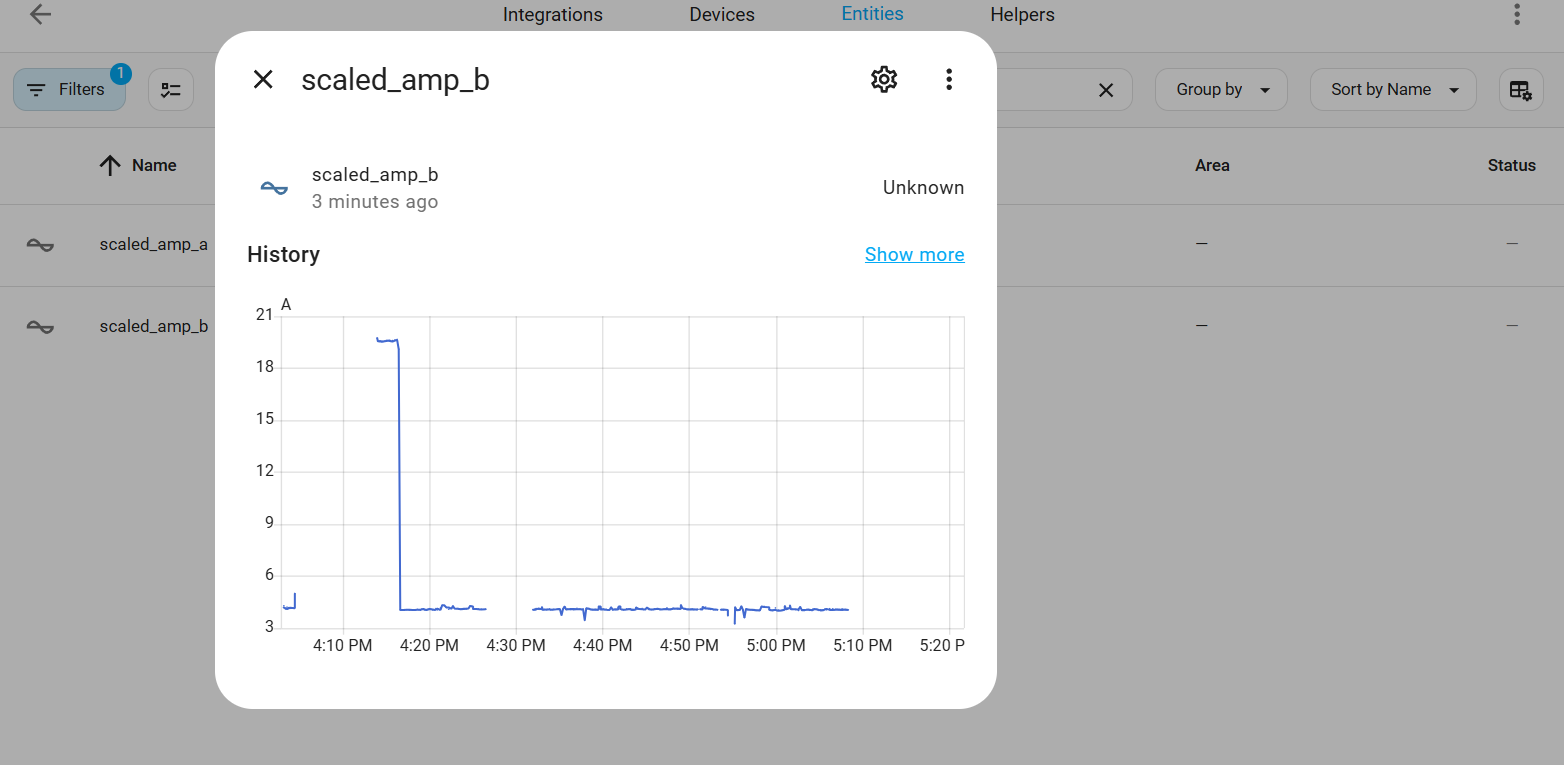

A is working but B is not
Share the YAML you are using.
Fixed! I must’ve pasted it wrong. WOW thank you ever so much Tom!
