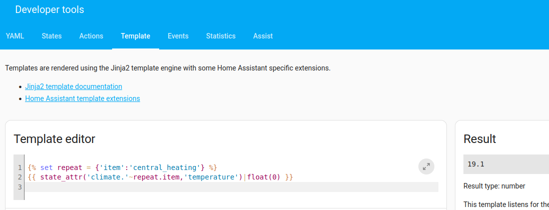

You can test in Developer Tools / Template Editor to some extent, setting up your own repeat and trigger structures as required:

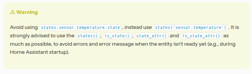

The key here is to use methods that use strings that you can build up rather than direct references, so states(), state_attr() rather than the dot references to the entities. See the warning box on the Templating page:
