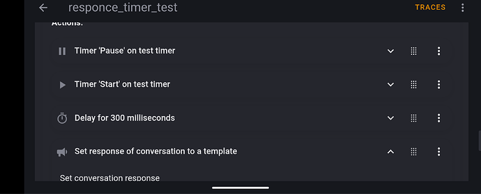

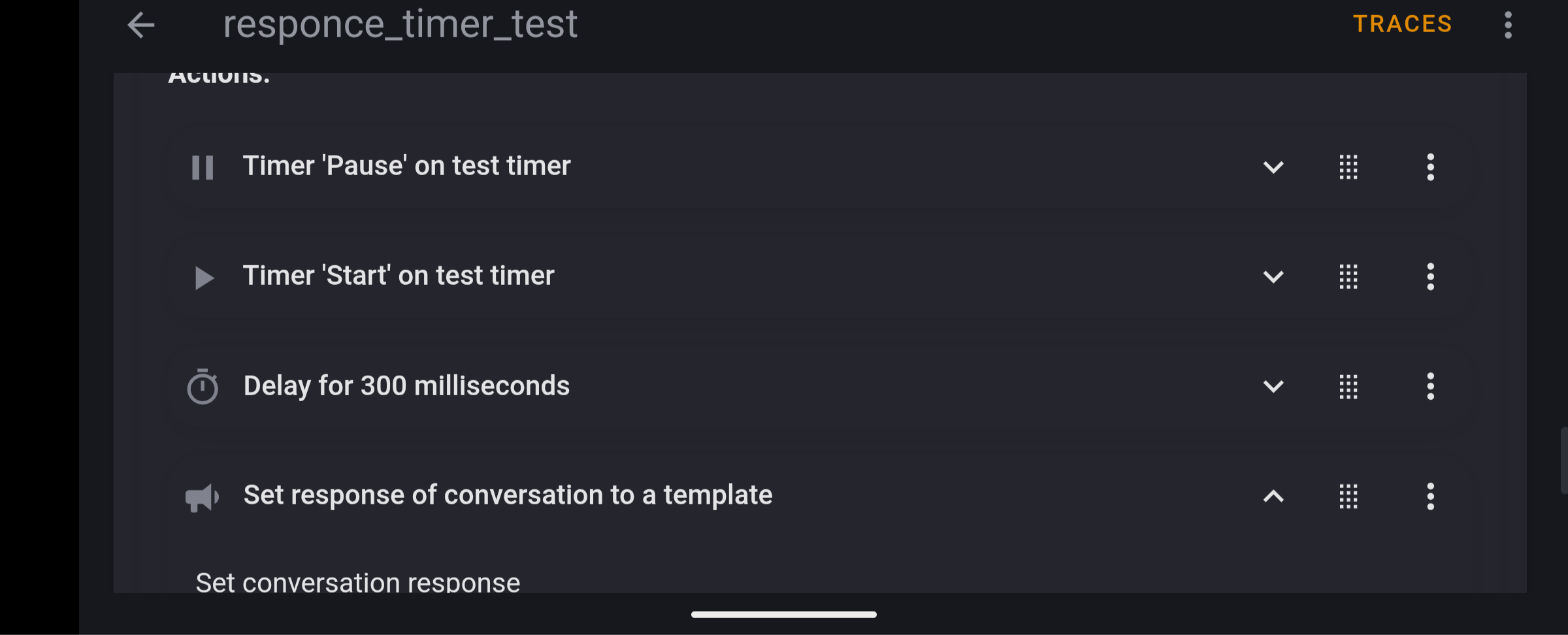

I came up with a different solution when creating my own timers using voice via automations. I created the template sensor below
- platform: template
  sensors:
    timer_display:
      value_template: >-
       {% set f = state_attr('timer.test_timer', 'finishes_at') %}
       {{ '00:00:00' if f == None else
        (as_datetime(f) - now()).total_seconds() | timestamp_custom('%H:%M:%S', false) }}
Then in my auction when triggered by the sentence " time remaining it does the below. The 300ms delay is because on rare occasions the template sensor would not get updated before replaying. It’s not the most elegant solution but it’s always work for me.
Conversation response
There is {% if is_state('timer.test_timer', 'active') %} {{ states('sensor.timer_display') }} {% else %} no timer set or remaining {% endif %}
