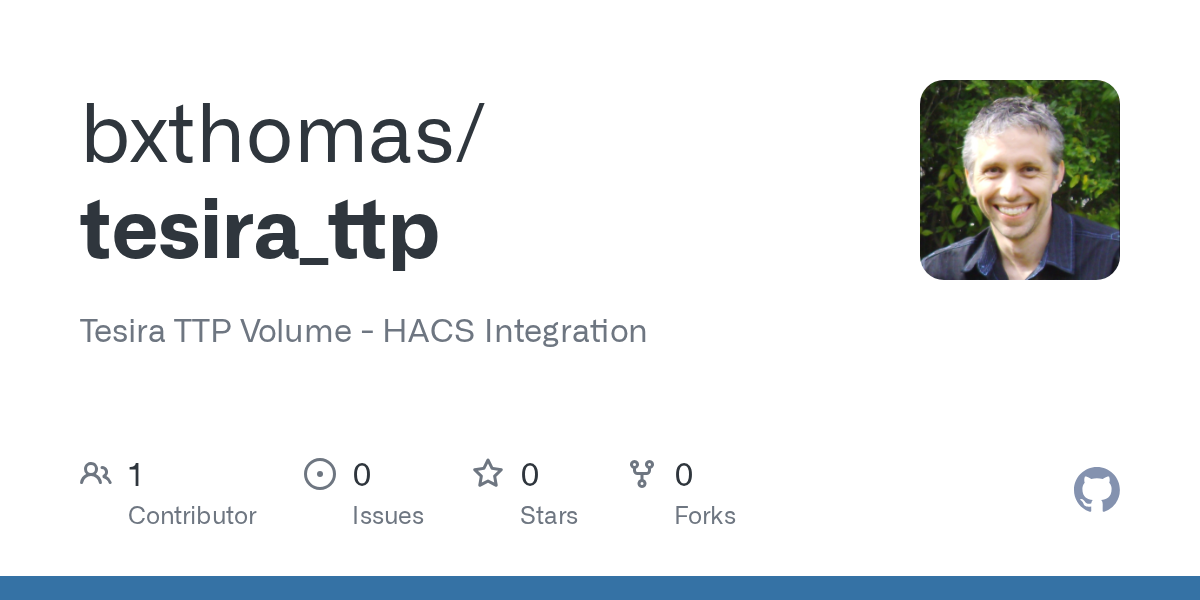

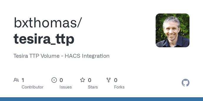

I bought some Biamp Tesira gear from eBay recently and so decided to write this integration.
This HACS works great! Thanks for this!!
