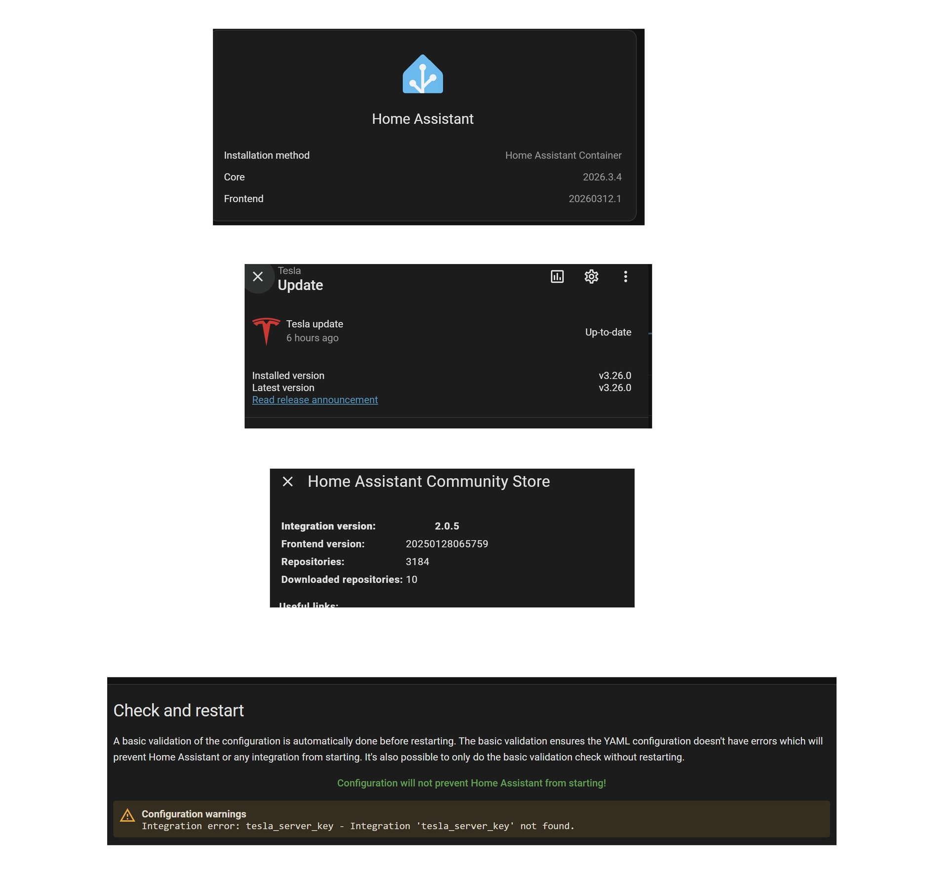

When I say App, I mean register the end-point in my HACS Tesla Fleet integration.
When I do a configuration check I get these non fatal errors:
  • I do not own a Tesla car, so I have no need to pair a key.
  • There does not appear to be a pairing capability with the Powerwall 3
I'm not seeing any log messages.
Anything else needed, I'll do my best to collect.

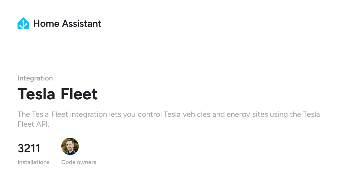

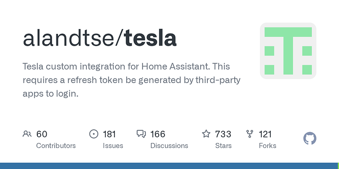

Have you followed the steps in the second paragraph here?
or is it the first paragraph here?
Are you sure you need the Fleet app (vehicles) and not the PowerWall (batteries) app?
Thank you, updating to the latest release did the job.
