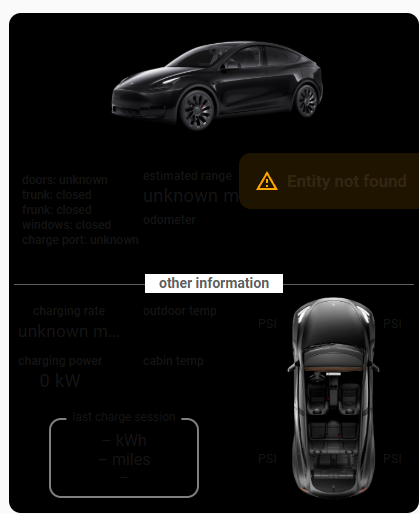

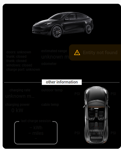

Does this yaml code still work for everyone? I followed the directions to the letter, and I can’t get the card to render properly. I’ve verified the values are showing up in developer tools.
Also, does anyone have the overhead view for the 2 row (5 passenger) Model Y?

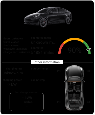

@nickjhowe, I found one issue in the current code. It looks like the entry for battery is now battery_level (with the hard coded name) for the gauge.

I’m still not seeing any other information on my card. I’m wondering if there is a text color issue in the card…
I got the code working for me. The only issue I had to fix is my car name has . in the name, and entity name changed the . to _. After that it works out good. The battery level for me (2018 M3) is still car_name_battery
