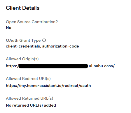

OK, I used the custom component and then pointing to my Nabu Casa URL.
I didn’t see that particular error. From memory it went pretty much like the documented instructions once I had everything setup but I did have to clear everything out a couple of times and also archive my Tesla Dev app and create a new one. Not sure which if any bits needed cleaning up but on successful attempt with everything cleaned up it went straight through.
And yep, at step 4 it asked me for the domain.

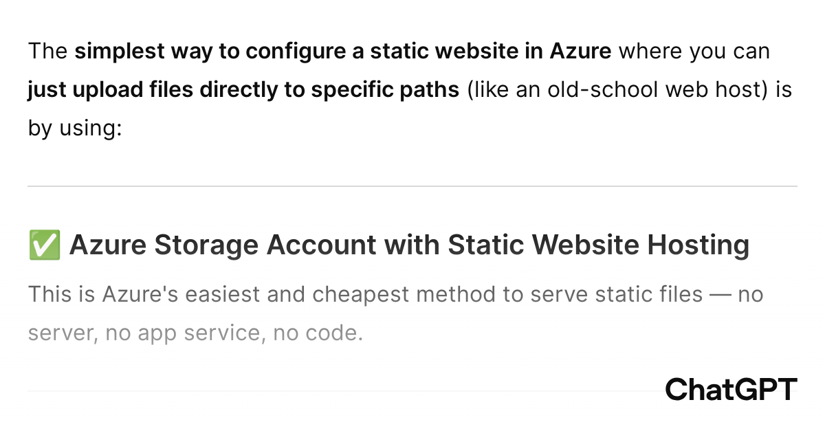

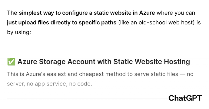

I was able to configure it using an Azure storage account with static hosting, I didn’t have to setup a custom domain, the default one https://<yourstorageaccount>.z13.web.core.windows.net/ worked just fine. ChatGPT proposed this solution and walked me through the steps, it was fairly simple. Hosting the 180 bytes of the pubkey for a month rounds to zero cents: $0.0000023/month (0.0023 cents/month)
@FabioSan Would you mind sharing the steps for people to recreate?

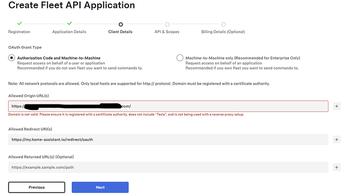

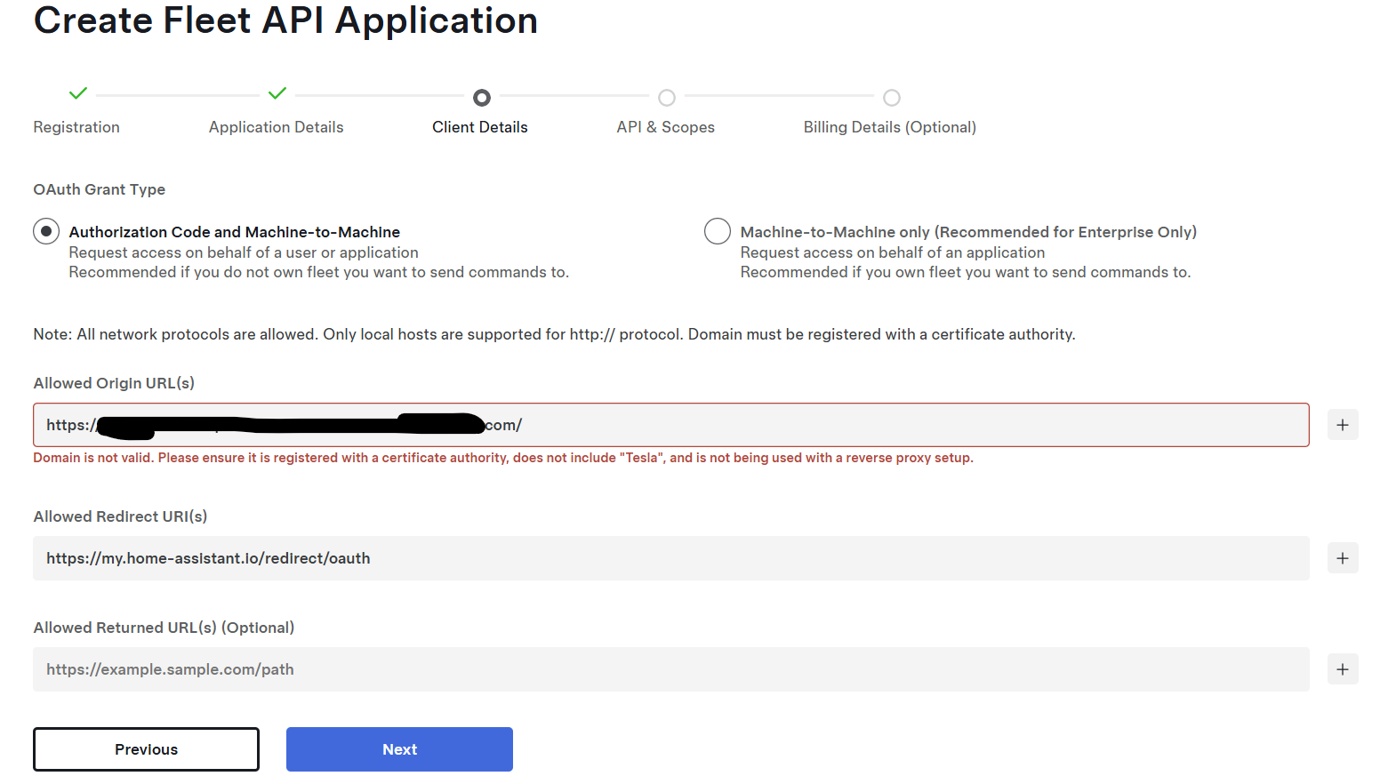

I’m struggling with Tesla Fleet API integration and thought this community might have some insights. I originally posted here Tesla Fleet integration: virtual key removed by Tesla after 10-30 minutes but figured more eyes might be the better chance of solving this.
If you’ve set up Tesla Fleet recently or have any experience with their public key validation, I’d really appreciate any pointers! Thanks!
What’s wrong? My domain works perfectly from the internet… yes it is presented via NMP (Nginx Proxy Manager).
But how could I achieve it else?
