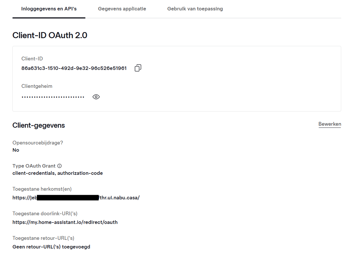

I’ve setup a Tesla developer account and generated oauth credentials:

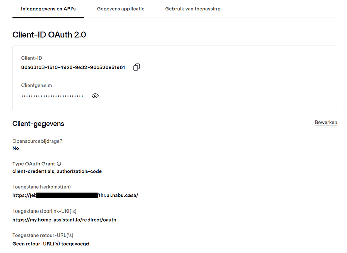

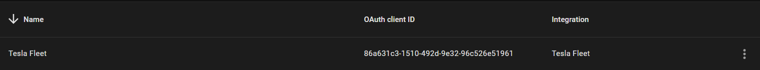

Said oauth credentials are configured to use in the integration:

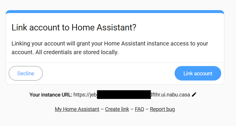

Redirect is working just fine:

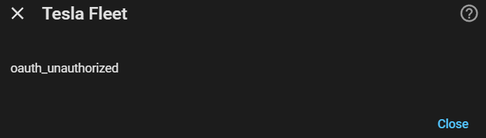

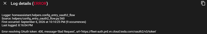

But then I just get:

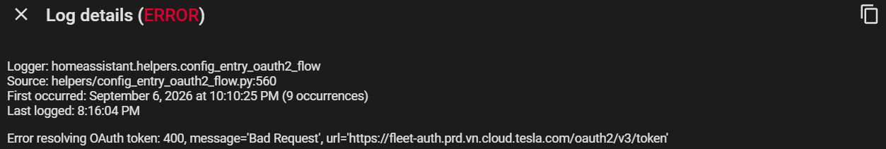

And in the logs it shows bad request as cause:

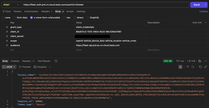

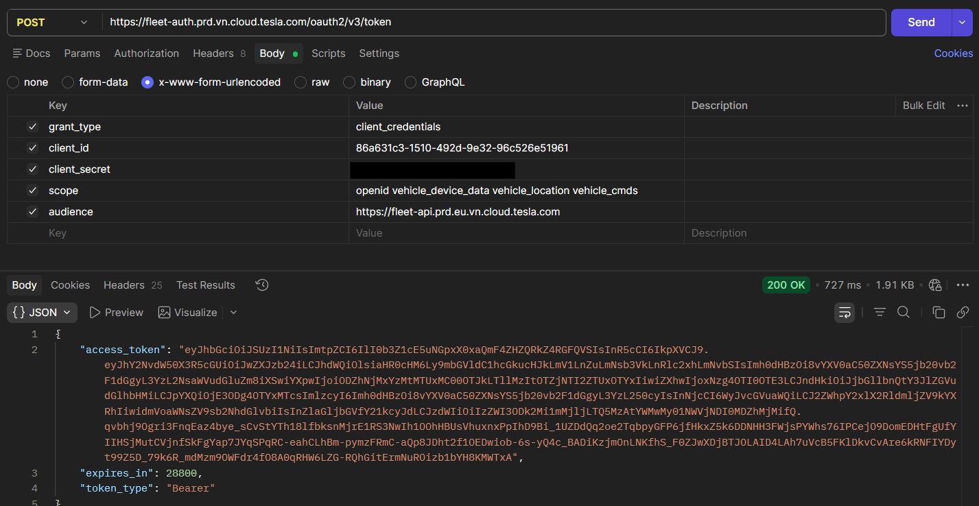

Also, I’ve tried to fetch a token with my credentials using postman, which was succesful:
So that is strange indeed.

Solve it. Turns out the integration doesn’t URL encode properly.
Tesla generated a % in the secret which got encoded instead of sent as plain text.
Creating a new app until no HTML characters where present (I now have a * and a ^) resulted in successful authentication.
