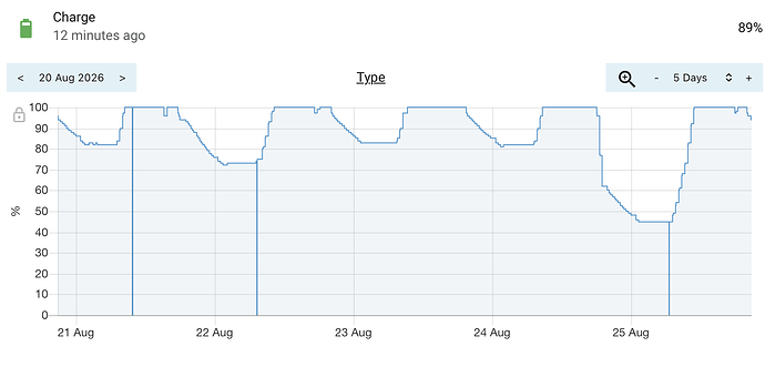

The most annoying aspect is that the integration changes values like charge level to zero rather than just setting it unavailable, this means the data ends up full of zeros…keep meaning to raise a problem report…

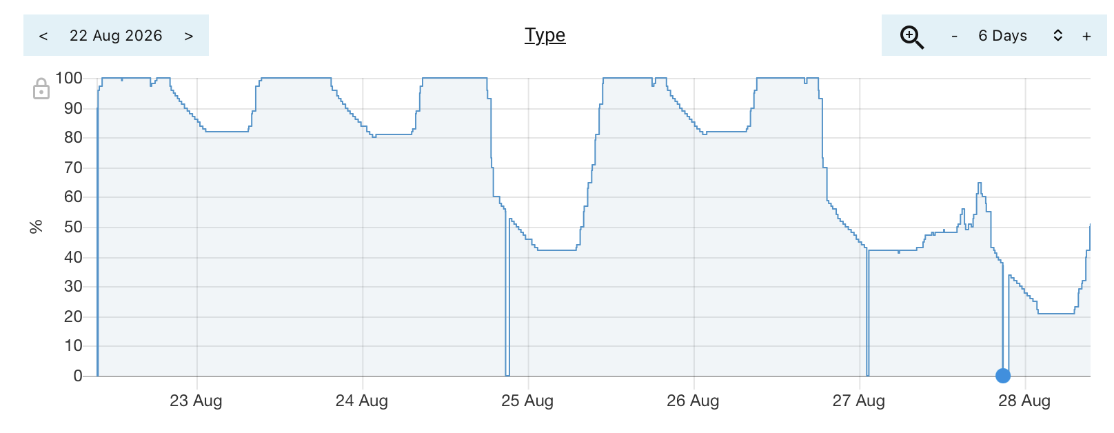

Mine is only for 30s to a few minutes but the data looks like this with zeros inserted. It’s hopeless when you’re trying to log minimum voltages as the minimum over a period is always zero.
