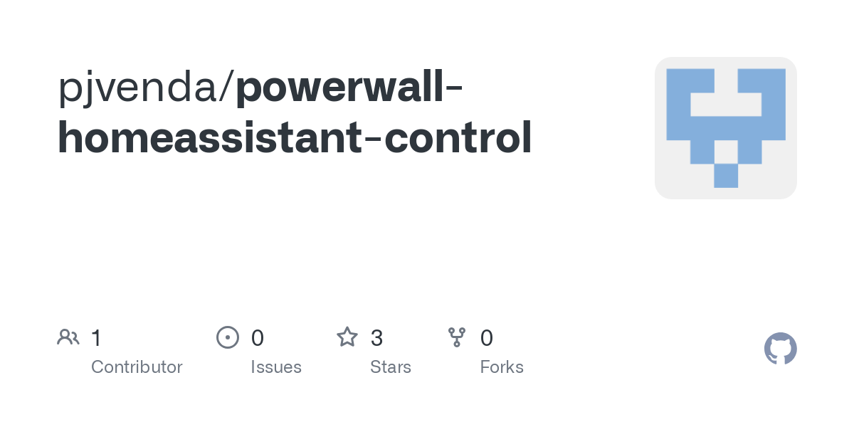

I’ve created three scripts to attempt to control the PW2. They aren’t effective. Has anybody got something similar working?

Have you tried the scripts that I published?

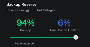

As of this morning my Tesla sends Code:Error when attempting to alter the backup reserve value. I can still change modes, but setting backup reserve fails
I’m using the custom Tesla integration (alandtse/tesla: Tesla custom integration for Home Assistant. This requires a refresh token be generated by third-party apps to login.) and it seems like the maximum the Backup Reserve value I can set right now is 80% for my Tesla Powerwall 2.
So, currently this action results in an error message, but still ups the number from the normal 20% to 80%:
  value: "95"
  entity_id: number.pw2_battery_both_custom_backup_reserve
action: number.set_value
But that’s not really what I’m looking for when I want to make sure that my battery is charged as much as possible before the peak tariff sets in :frowning:
P.S.:
Doesn’t look like I can set it any higher in the Tesla App either.
I can initially set it to a higher value there, but I can see within 30 seconds in the app and my HA Dashboard that the value is taken down to 80% as well.
behaviour I’m seeing is same ā€œfailed to perform actionā€ messages as you, and not able to push any change to reserve value successfully to the powerwall itself.
the other attributes seem to still be working (such as export energy solar/everything/none)
discussion here: All calls to set backup reserve level fail; errors in HA log - possible Tesla API change? Ā· Issue #1125 Ā· alandtse/tesla Ā· GitHub
so it seems possibly more than one issue
  • can’t push change to reserve value from HA, some broken-ness between HA and tesla
  • can’t set a reserve value greater than 100 - nothing to do with HA, just an arbitrary decision by tesla, which isn’t on, we own the boxes, let us decide how much charge we want at any one time
and in my case, confusion because I started to do a long overdue upgrade at about the same time as Tesla started tweaking stuff :frowning:
I don’t need a value greater than 100 :face_with_open_eyes_and_hand_over_mouth:
But it seems like I can only set values of 80 or less or exactly 100.
Typo :slight_smile:
