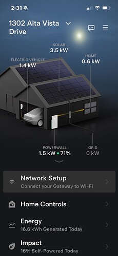

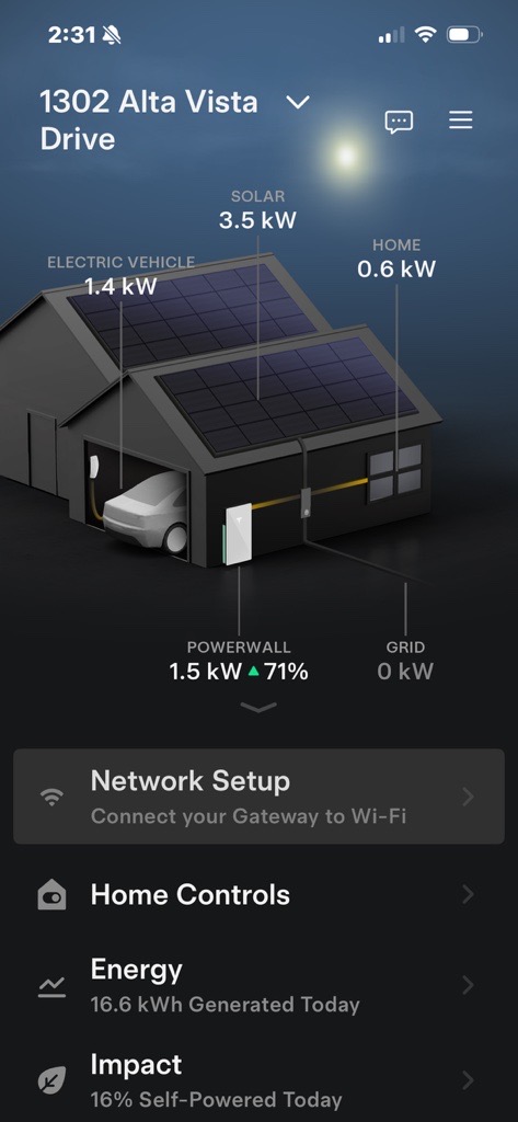

After two charges, I can confirm that it works really well.
Gentlemen - @olaliv @Zany @PVi1 @Klangen82 and all the supporting team - I can’t tell you how happy I was today to finally mediate our Leaf’s charging with the ESP32 integration! I now have a stand alone ESPHome LoadPilot derived satellite capable of control based on demand which is then driven by a blueprint based automation taking into account powerwall state, solar excess and VPP event. Looking forward to optimising the latter - but the former is all you guys - thanks for your patience and ingenuity. I’m off to Mexico City now for a weeks holiday - already with a smile on my face. Cheers, DJ

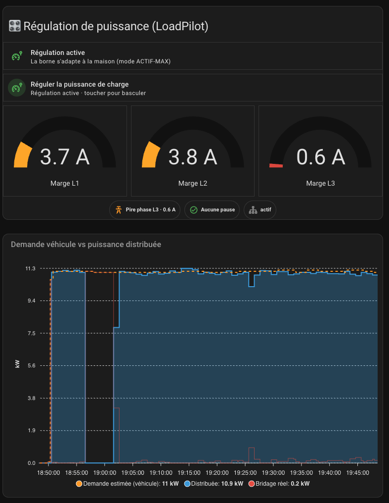

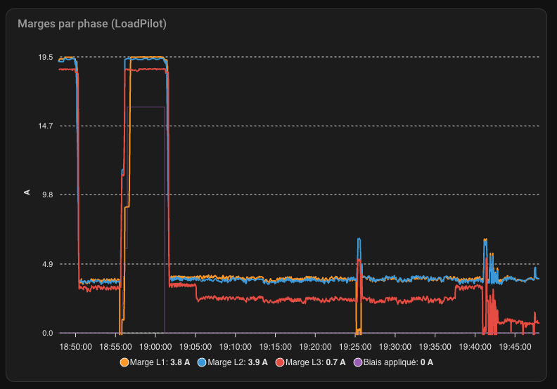

It corroborates something I had measured on my own pilot from a completely different angle. I had characterised the dead band as a hysteresis rather than a threshold: from rest the wallbox only engages at about L+0.85, and once it is pulling it tracks all the way back down to published = L, the exact budget equilibrium, and holds there. Your “+0.9 A reduces after tens of seconds” is the same point reached by a different method. Two independent instrumentations, one threshold.
Your curve also caught a real defect in my own defaults, so this is not just agreement. LoadPilot shipped law_emax_default at 1.0 A, and the published value carries a permanent +/-0.05 A dither on top, so the law could peak at L+1.05. By your curve that is inside the inconsistent band and 0.05 A away from the band that stops the charge outright in three seconds. I had surprise charge stops on my pilot that I could never fully explain. That is a plausible mechanism, and I would not have looked there without your post.
I have capped the ceiling at 0.9 A (v1.4.0, pushed today). The peak becomes L+0.95, which still breaks the dead band while keeping 0.15 A of margin below the stop band. The ceiling now deliberately equals my stage-2 kick, so the continuous law and the anti-hysteresis kick target the same measured point.
