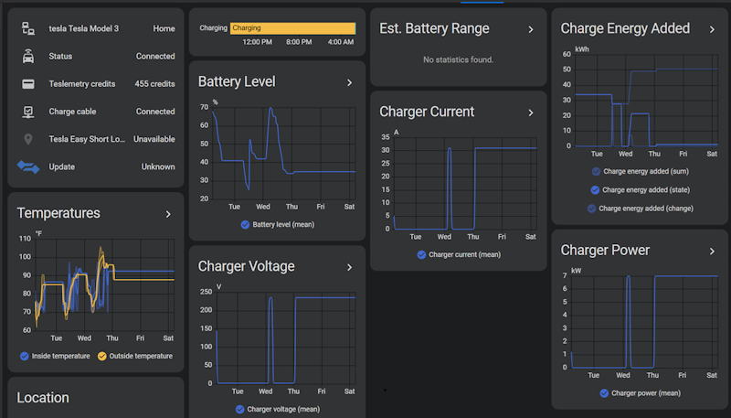

Trying to figure out why the Teslemetry integration stopped updating stats from my Model 3, a couple of days ago. I reloaded the integration, got the Tesla login and authorization, which then said it has already been authorized.
Is the problem with the HA integration? Or the car?
Update: As with many things, restarting HA helps. This did help for some but not all devices. Still to get working again: the Est. Battery Range, and the Update Status sensors. I found the sensor "Battery Range" which works, while the 'Est. Battery Range' does not. The update.update sensor was disabled, and is working now.
