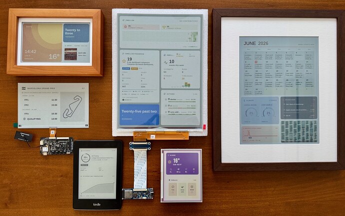

Tesserae is a self-hosted dashboard companion for e-ink panels: compose tile-based dashboards out of widgets in a web UI, render them headless, then push the frames to physical displays. Works with Pimoroni Inky (pHAT, wHAT, Impression 4"/5.7"/7.3"/13.3"), Waveshare Spectra 6 driven by an ESP32, TRMNL devices (Seeed Studio hardware running the TRMNL firmware, pictured above with the resident QA inspector), and Kindles running KOReader's trmnl-display plugin.

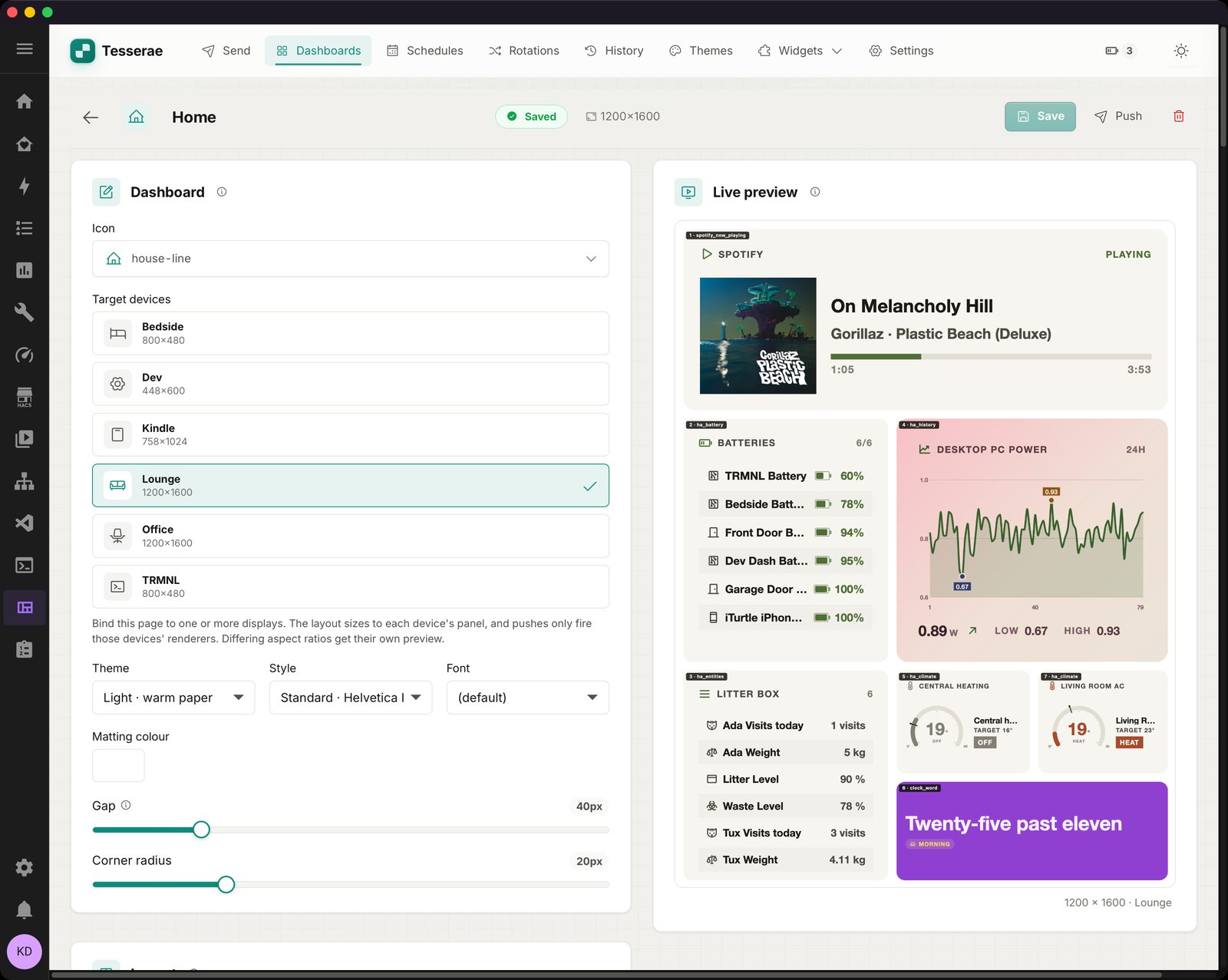

One Tesserae instance drives a whole household of panels at once, each with its own dashboard. Above each card is a live preview of what's currently on the device.
Dashboards are tile-based. Pick a layout preset (single cell, 2×2 grid, hero top/bottom, etc.), assign a widget per cell, pick a theme. The dashboard's panel block sizes to the device you're binding to, so the same composition retargets to a different panel just by ticking a different device.

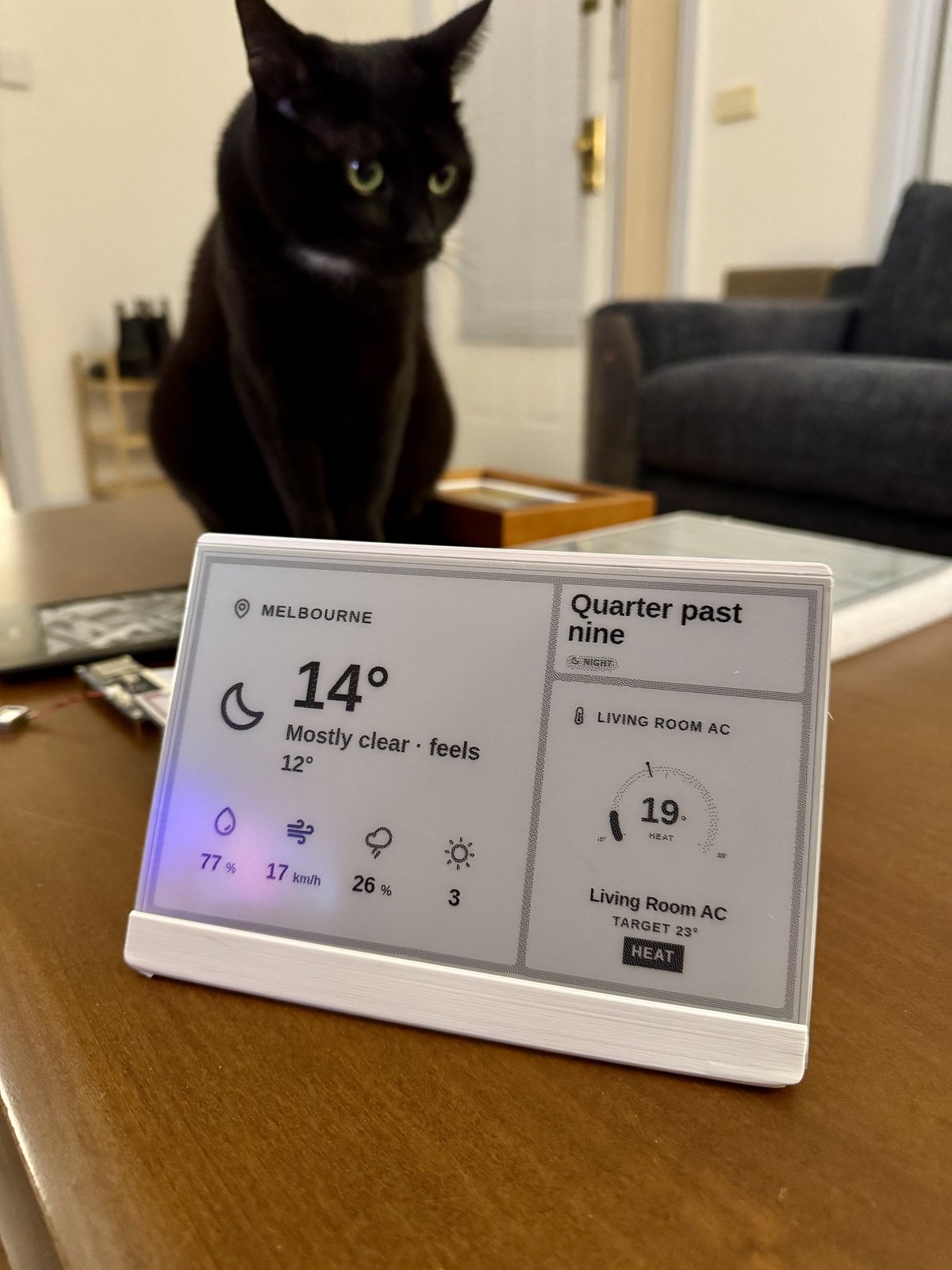

Landscape panels work the same way. This Bedside dashboard binds to a landscape waveshare photo painter running custom firmware.

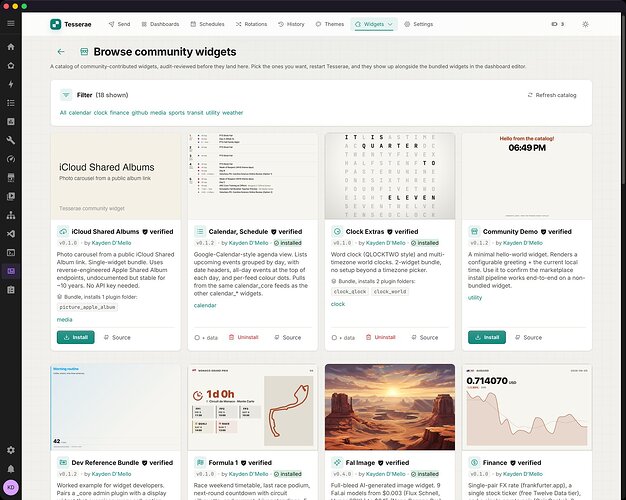

There's also a small but growing community widget catalog you can browse and install from inside the UI: extra calendar views, a Spotify now-playing widget, AI-image-generation if you want a different wallpaper every morning, plus a few utility bundles.

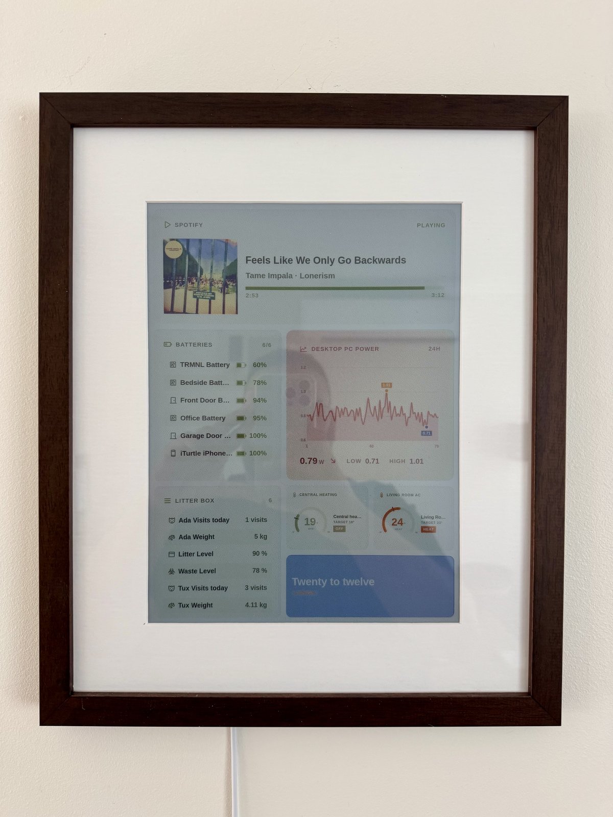

It works just as well as wall art. This one (in our hallway) cycles between batteries, Spotify, and a litter-box weight tracker.
