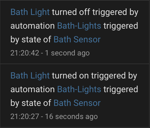

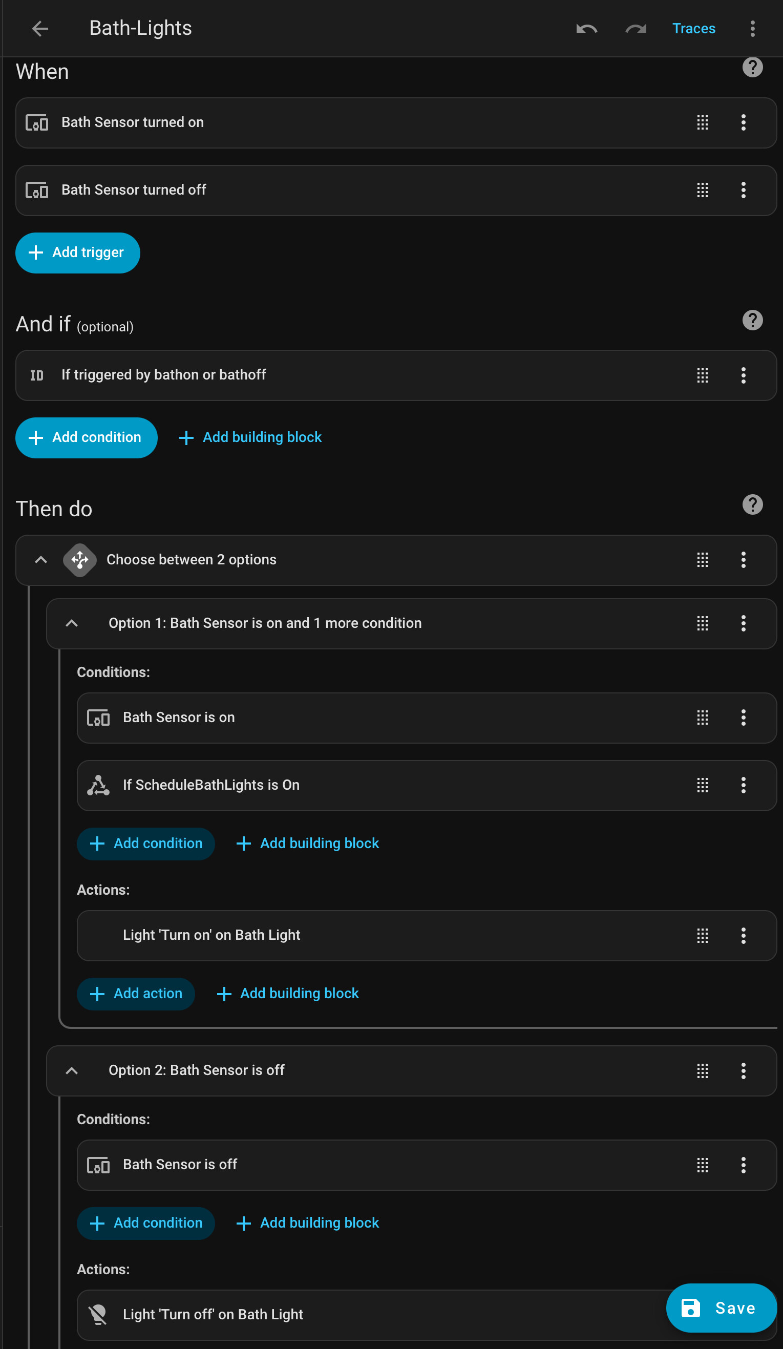

I have a schedule during which the bathroom lights will be turned on and off based on a motion sensor, this is what that looks like
Works great, easy enough.

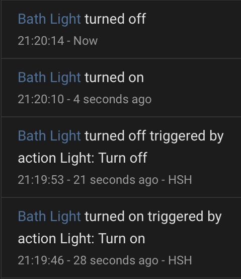

Now I wish to expand this so that if the light is turned on via the app or the physical switch… the automation should not turn it off or on
This is how these look like
How on earth can I test for this and put it into the automation.

Here is what I have so far.
