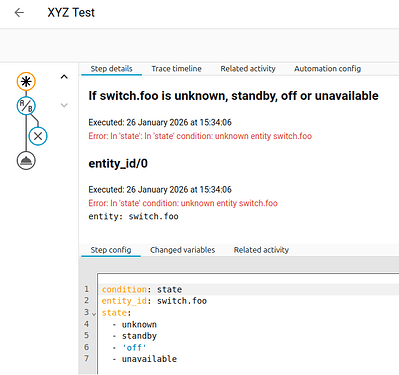

  - condition: state
    entity_id: media_player.apple_tv_family_room
    state:
      - unknown
      - standby
      - "off"
      - unavailable
A little confusing if you were expecting to test for a state that states(...) returns, right?
It did not. VDRainer commented that it “only works with the states.entity_id.state notation.”
There’s a subtle but important difference between the two types of conditions.
  • The Template Condition is employing the Jinja2 processor to evaluate its template. The states() function is responsible for determining the supplied entity’s state. Whoever created the function, chose to have it report unknown if it cannot locate a valid entity_id.
  • The State Condition is employing python to evaluate the YAML code. Whoever wrote it chose to report the lack of a valid entity_id as an error.
