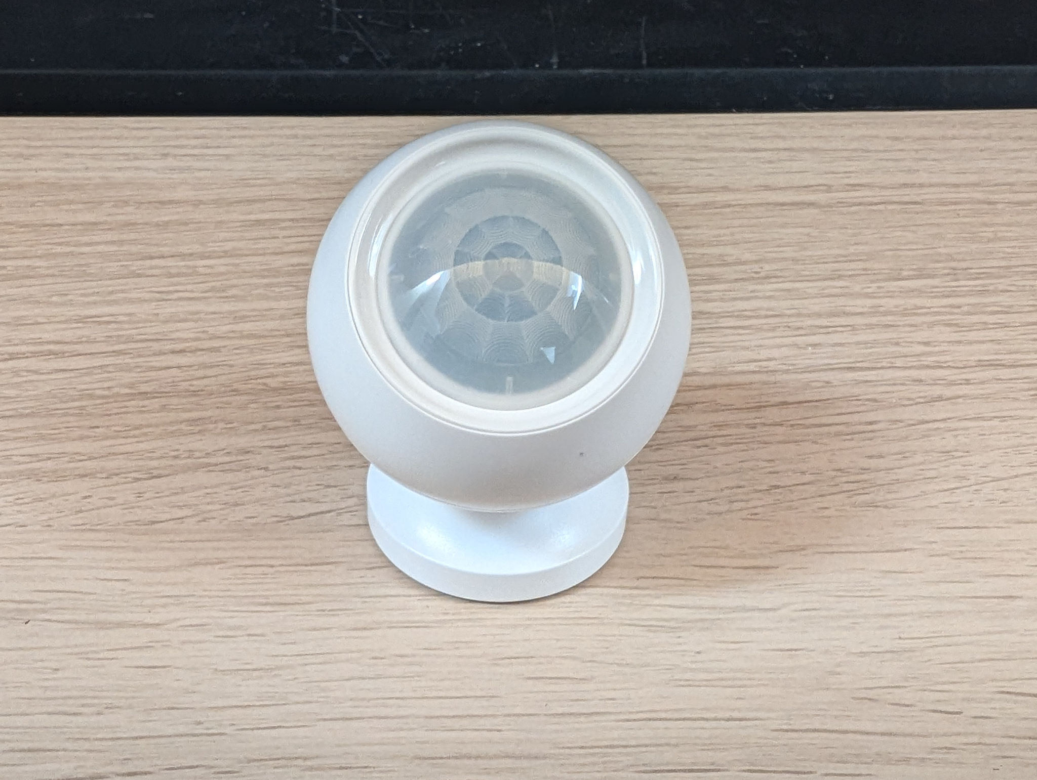

At first glance, the device feels solid and well-built. Its spherical design gives it a subtle “eye” look, and while it’s slightly larger than my Aqara, it’s not bulky at all. The magnetic base makes mounting quick and easy—unlike the Aqara, which sometimes has to be unmounted from the wall since its base only pivots in one direction (rotation aside). When my son first saw it, he was a little spooked by the “eye” shape (he’s wary of just about everything!), but after a few hours, and especially after I turned off the red detection LED, he completely forgot it was there, thanks to its compact size and discreet placement.

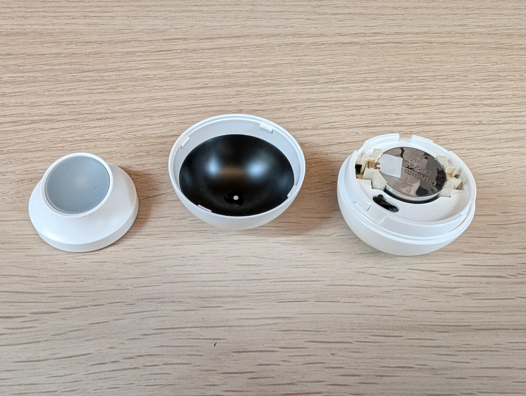

I won’t dive into the hardware specifics, as I haven’t taken it apart and prefer to keep this from a pure end-user perspective. The only hardware detail I’ll mention here is that it runs on a standard CR2450 battery. For the rest of the technical specs, several other reviews online cover it thoroughly if you’re curious.

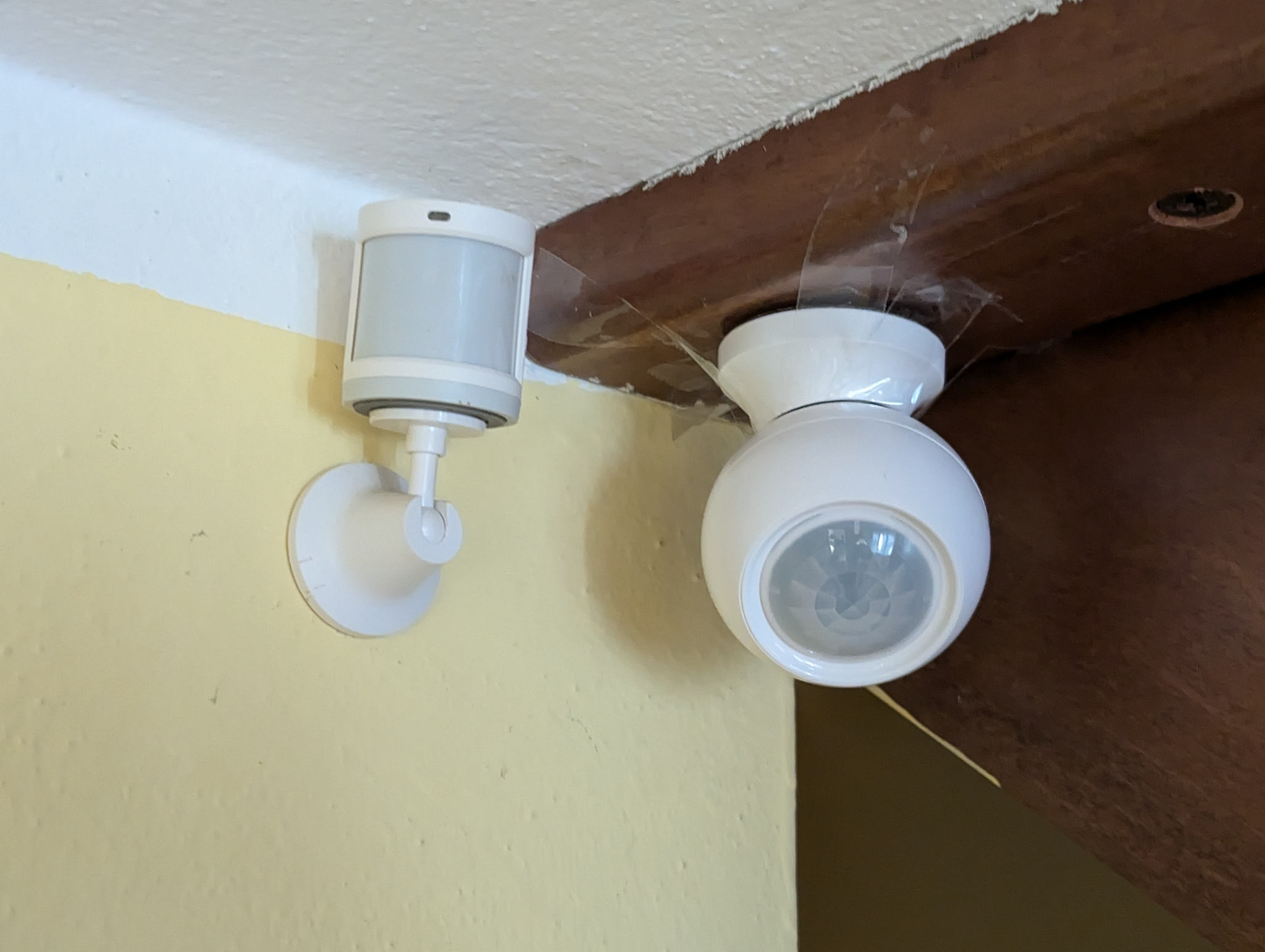

To test its performance, I placed the ZPS-Z1 right next to the Aqara in my living room (securing it with temporary tape for now, as you can see in the photo above, so I can reserve the pre-applied adhesive for permanent installation :slight_smile: ).
After a few days of testing, here’s what I found:
• The Aqara has a wider detection angle (confirmed by specs: 170° vs. 110°), thanks to its flat, fan-shaped coverage pattern compared to the Zemismart’s 360° omnidirectional field. This suggests I should have positioned the Zemismart in a more optimal location, but as mentioned, I wanted a strict 1:1 comparison. Nevertheless, the detection performance was nearly identical, with only a slightly narrower horizontal coverage compared to the Aqara. Yet it still reliably covers the areas that matter most to me.
