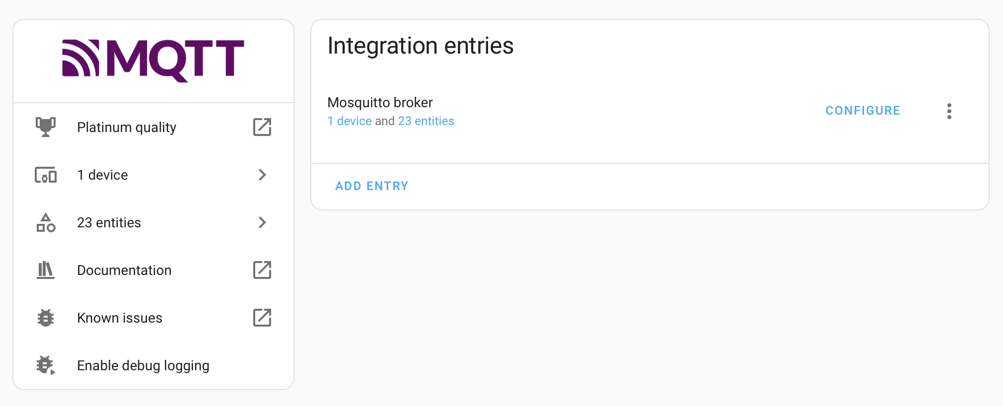

I’ve installed a comip module and built texecom2mqtt.
I can see it’s connecting to the panel and retrieving data okay. The logs show data being published to Mosquito MQTT.
2025-06-29 19:32:03 - DEBUG: Publishing to texecom2mqtt/config: '{"version":"1.3.1","log_level":"debug","model":"Premier Elite 24","firmware_version":"V6.05.03LS1","serial_number":"removed"}' (retain: true)
However, when I view MQTT the device doesn’t show:
I only see an existing unrelated device there.

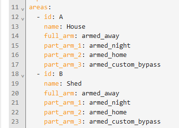

I’m having a problem with areas and i cant figure out why.
I have 2 areas, and my config yaml is as follows-
In the texecom2mqtt log i can see that the areas are fetched OK:
But then the last entry on the log gives me an error about my config and an ‘Unknown area’:
Can anyone spot what the issue might be here?
