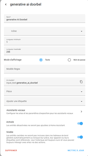

Text helper limit to 255 characters ? I was able to bug it
Instead of suing the up and down arrows in the window defining the text helper (the upper arrow only allows you to go up to 255), I just entered “2555” and saved it … as simple as that

But your text helper max attribute is still set to 255 characters ?
Your text seems to be 447 characters long. In my case trying to put more than 255 characters was just NOT updating the text helper. Text helper was only updating if the AI answer was LESS than 255 characters.
Only from the moment I was able to increase the text helper max attribute to 2555, then it was updated with long text.
And my version was 2025.2.x … I just updated to 2025.3 and haven’t tested with that version yet, but I assume this doesn’t change anything
it is set to 1000.
Where are you guys seeing the length setting. I see nothing…
Check your Home Assistant user account and ensure Advanced Mode is enabled. It controls the display of various options throughout the UI.
I thought I had Advanced Mode enabled previously. But is was off. Thank you! With that said, I do wish the text was longer than 255. Especially when trying to craft something for a markdown card.
For some reason I THINK since the Upgrade to Core 2025.3.1, my text helper which I manually bugged from 255 characters to 2555 characters is not working anymore … I see this in the UI :
… even if I set it bac to 255 characters, It remains “unconfigurable” :
