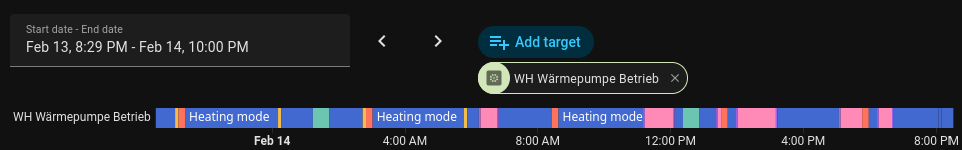

I am using Home assistant 2026.2 with the victoriametrics app. Everything is running well and i can visualize all the value-based sensors with grafana.

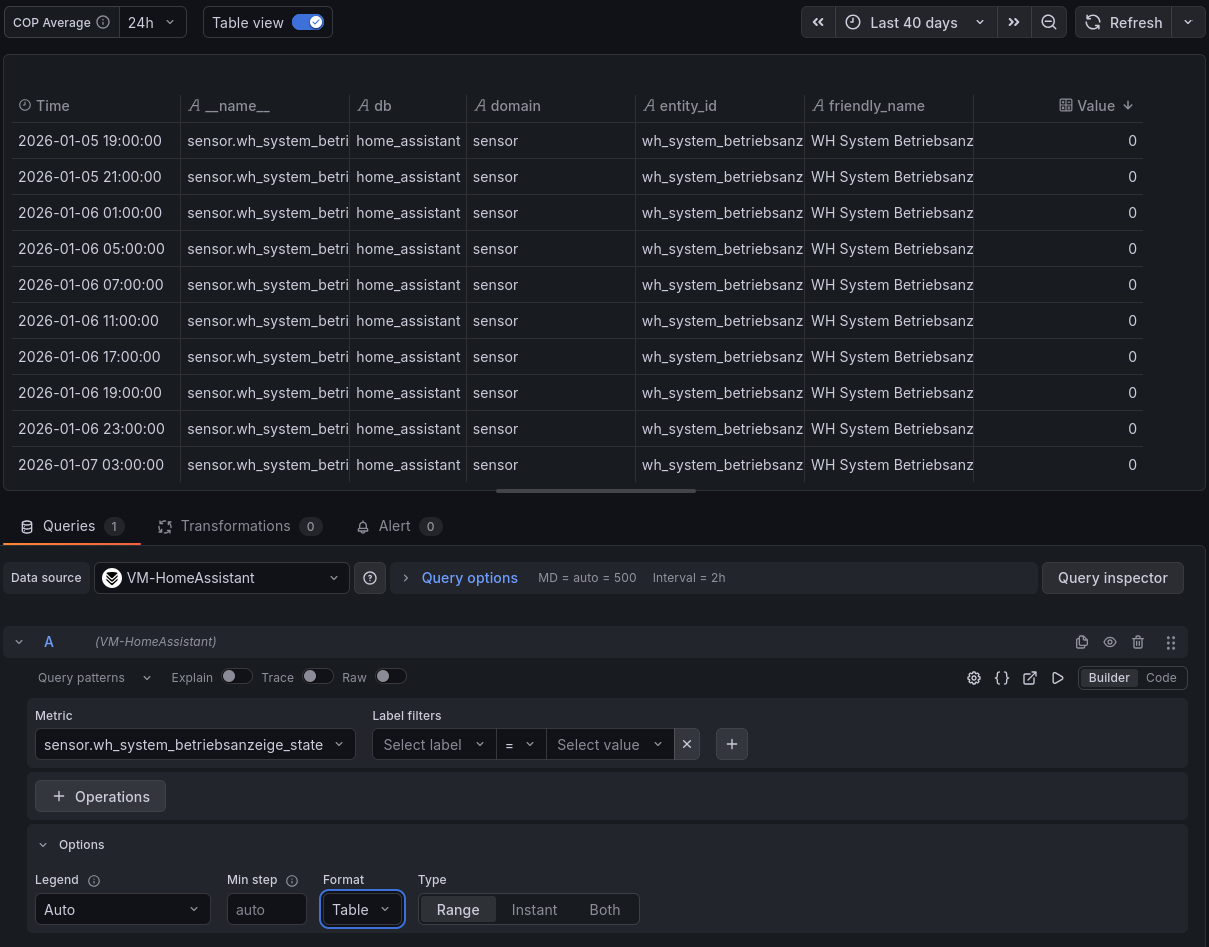

However, those sensors which hold text-based information are always displayed as ‘0’ in grafana.
How can I access the text information in grafana?
For example: I use the plugin Weishaupt Modbus which creates several sensors. One of them is the operation mode (heating, hot water, defrost, …).
If i use this sensor in grafana, the “value” is always zero and none of the fields available in grafana show any change.
Is it maybe I filter this attribute in my config (see below)?
Or do I just have to enter a magic string in my query for that? I have both the VictoriaMetrics and Prometheus Plugin in my grafana installation
