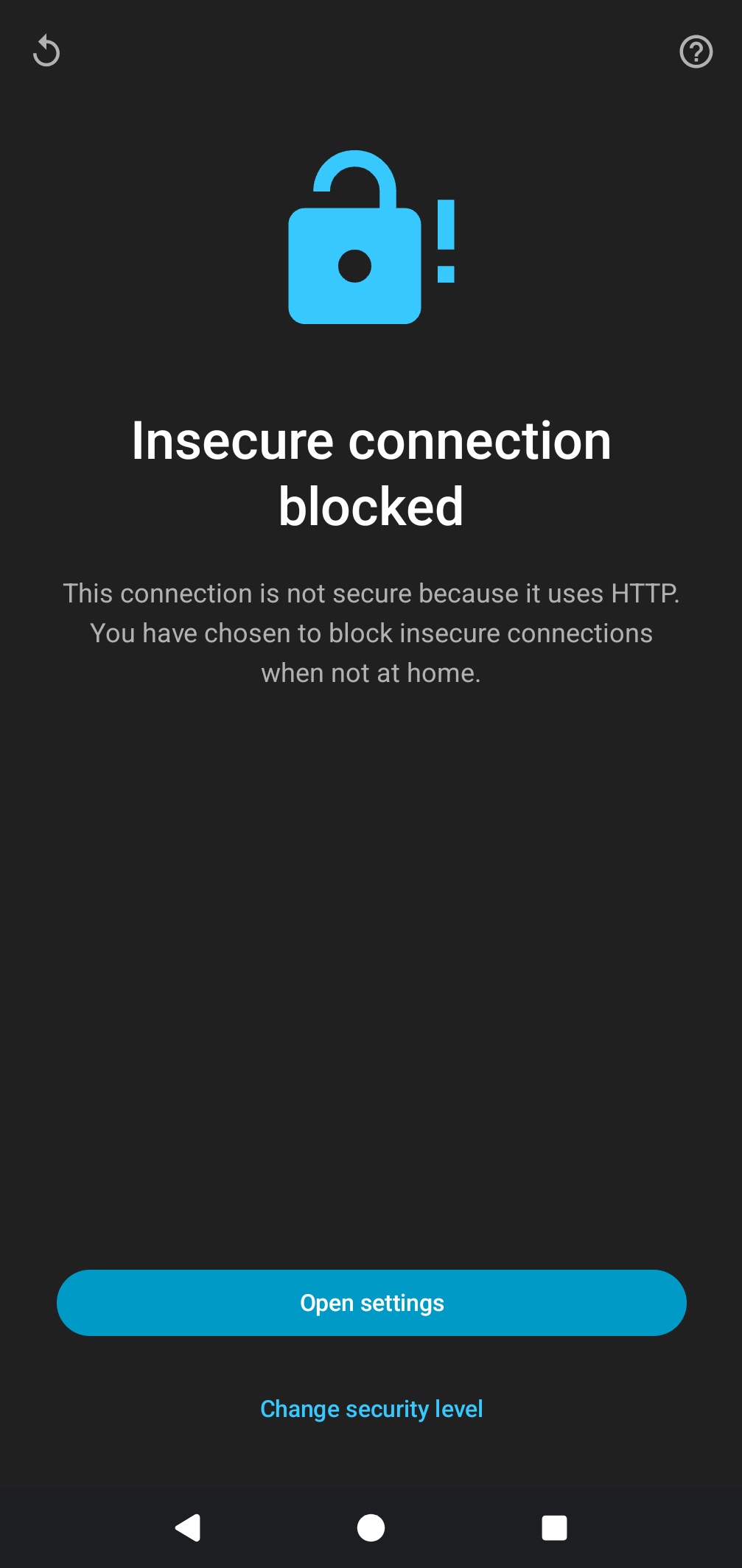

Now this never goes away.
Even after setting my connection to https and turning my VPN off.
I can no longer turn my fans down or check room temp.
This worked fine before and now I can't use home assistant at all!

Next thing to see is if you can manage to press the Change security level in that screen.
Once you do that, see if you can read this & either set the VPN option in Most Secure mode, or else switch to Less secure mode.
Such a shame they made you update without giving you any docs to explain what those options do. Oh wait...

I have seen this screen a couple of times on my e/OS phone. Not sure it has anything to do with the HA app, but it went away after a hard reset (of the phone).
