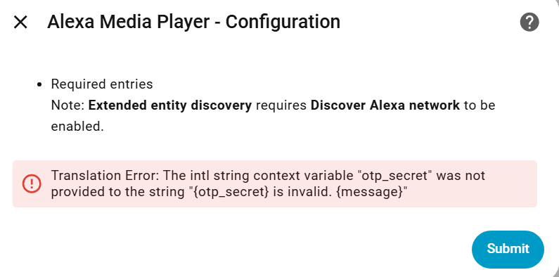

I upgraded to 5.8.0 but now I get the following:
The Amazon Skill IS enabled !
Just updated AMP to 5.8.0 and the issue is resolved for me.

@danielbrunt57 told me (on Github) how to do it right and it now works.

Looks like it could be working. I thought I had to enter the 6 digit code FROM the authentication app.

That is what I did wrong as well. You need to get a (long) code directly from Amazon.com .

Yes, use the Amazon “new app” authentication code. NOT through the Google (other equivalent) Authentication. I made that mistake.

Yep, I did that with initial setup. Looks like I had to regenerate the OTP.
