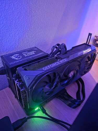

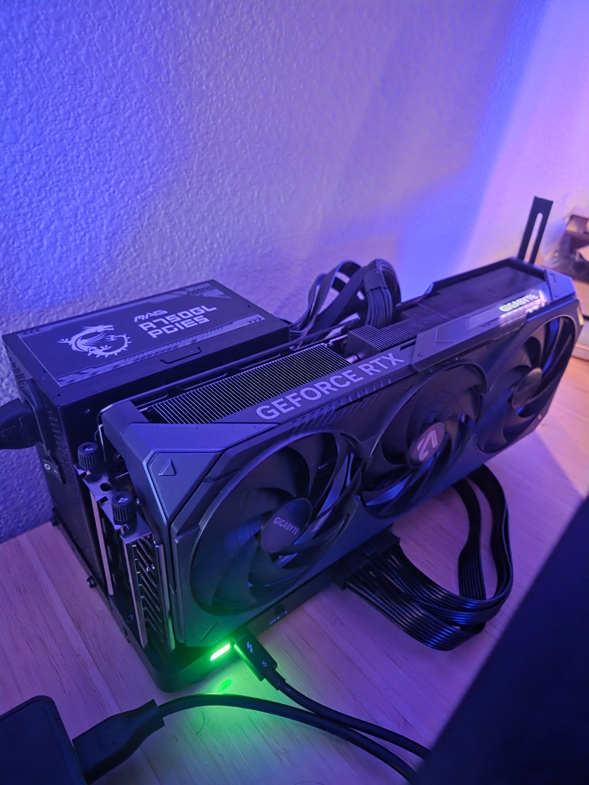

This 5070 is what Friday runs her primary local inference on and it’s STILL not good enough for 100% local for me. Probably one more card generation.
Is that for real, You are a Nerd :joy: :+1:
110% true. Also… I thought this was well established by now? :rofl:
I assume you don’t need any heating-elements in that room :slight_smile:
It’s surprisingly cool. Running BOTH that beast and the Intel a770xe onboard as many inference jobs as I do on the desk in my office it’s only actually running full power a fraction of its lifetime…
It spools down to ~30w standby very quickly. But I get near instant response from oss:20b, Llama3.2-vision, qwen3-vl, qwen3:8b at high token rates with large context.
Real talk, it’s about 100% more efficient (half the power use of, however that’s said) than my old desktop and I run this one and the NUC that’s my desktop pc now for less than the combined power use of the old ATX tower I had and I don’t play FarCry. (or whatever fps is stressing boxes now. I’m old)
