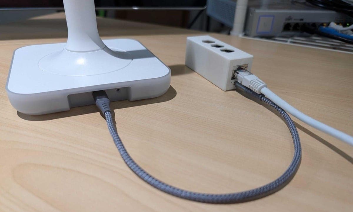

I know many don´t like USB extenders, but it works well for me. I have the ZBT-2 and a bluetooth adapter connected to my HA (running on a mini PC) this way. If you have Cat 5 Cable (or better) to a good place you could try. These are cheap and worth a try: https://www.aliexpress.com/item/1005004603772182.html

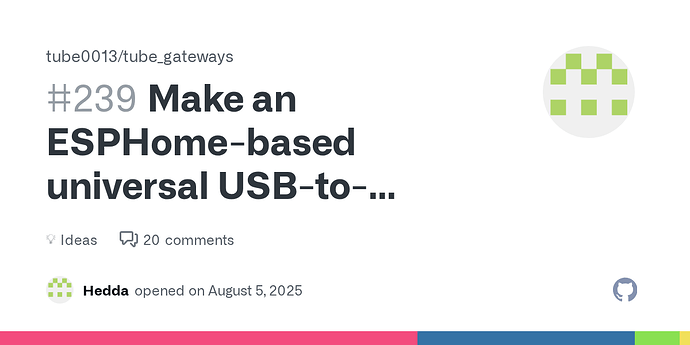

That is, you could develop a generic ESPHome-based universal USB-to-Ethernet Bridge, a USB to Serial-over-IP (Serial-over-LAN) proxy appliance compatible with standard Z-Wave Controller and Zigbee Coordinator USB adapters. See dicusssion about that idea here → Make an ESPHome-based universal USB-to-Ethernet Bridge, a USB to Serial-over-IP (Serial-over-LAN) proxy appliance compatible with standard Z-Wave Controller and Zigbee Coordinator USB adapters · tube0013/tube_gateways · Discussion #239 · GitHub

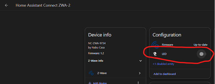

Any word on a POE solution yet? Similar to ZWA-2 would be great.
But how? I can’t even get mine to turn on… No identifiable entity to enable. Etc… :worried:
My previous comment was based on the assumption it would have controls like the ZWA does but I don’t have a ZBT.
