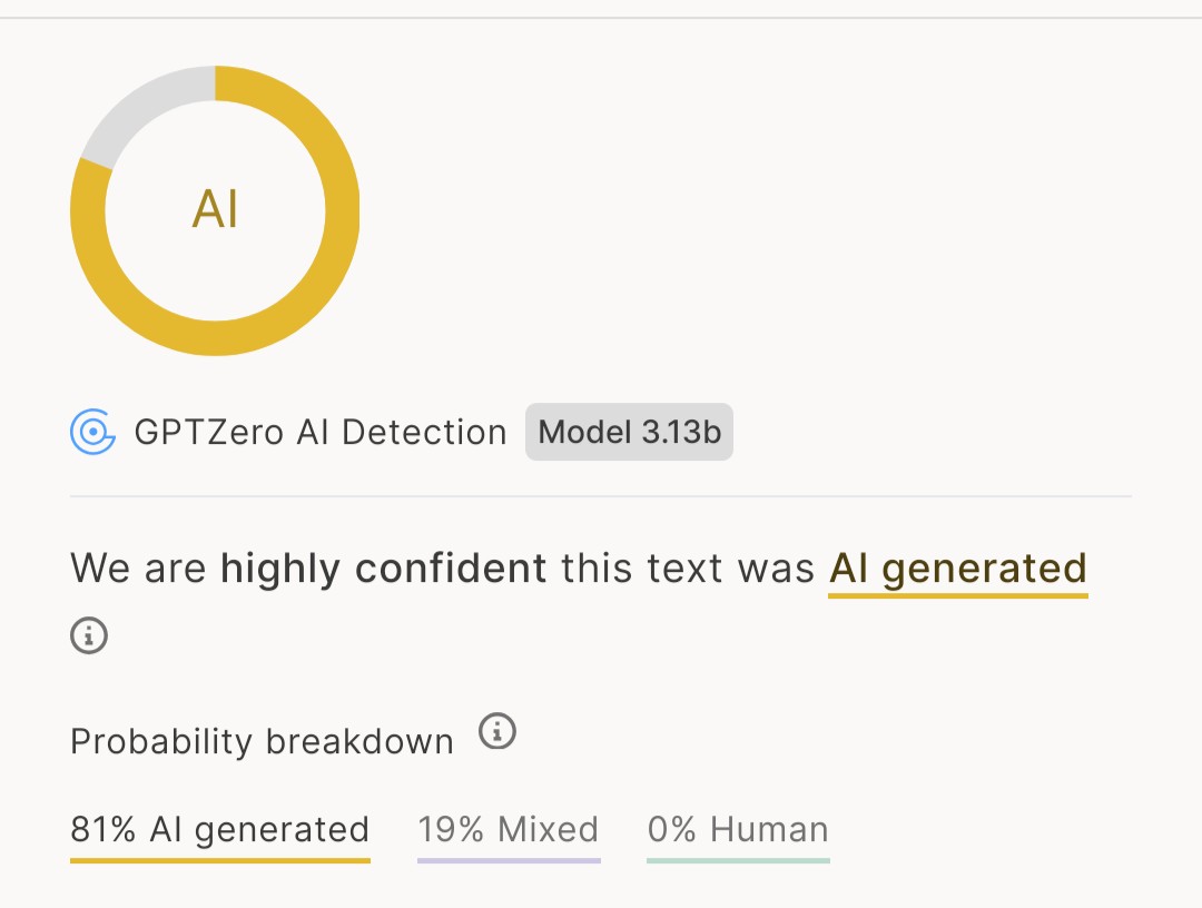

The analysis of your posts shows highly confident AI generated with some ~19% manual alterations on the text you published - still slop :face_vomiting:
Strange, I took time to look at your old posts and you never did this before. :person_shrugging:
…but you probably know that AI exactly behaves like this - right @edigorn?

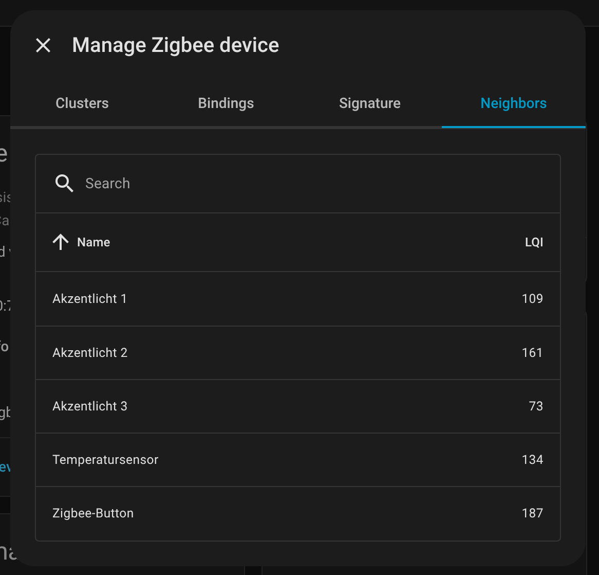

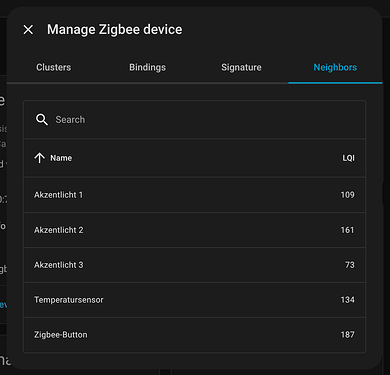

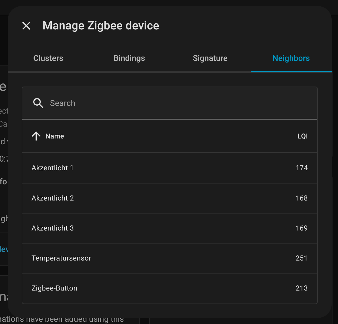

My ZBT-2 has lower LQI values than my ZBT-1, too. Not sure whether they are computed the same way though.
LQI ZBT-1:
LQI ZBT-2:
Zigbee LQI values are not comparable between manufacturers and might not be comparable between different chipsets and firmware versions (as there is no standardized methodology for measuring/calculating them).
