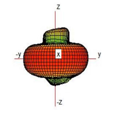

If the antenna design is tweaked to the relevant frequencies, and the base of the ZBT-2 also contains antenna related functionality, am I correct in asuming that i can’t turn it upside down? :thinking:
As an old school type IT guy, i leaned a long time ago that WiFi APs should be placed as high as possible, so as to get above furniture, people and other obstacles. :older_adult:
I bring that logic over onto my Zigbee and Z-wave sticks. :wink:
Upgrading to the ZBT-2, i would not want to install a shelf for it under the ceiling, so ceiling mouting it upside down was an idea.
Just seems not so smart to get a new shining coordinator, and then starting out by mounting it wrong and limiting it’s performance. :smiley:
I know an antenna is much more than just a bigger surface for waves to hit, but what are the facts here?
Upside down or no upside down?
Best regards
Niels
I haven’t found much on the antenna’s design, so I’m just speculating here:
Ground planes, if placed a proper distance from the antenna and large enough, tend to push the signal more away from the ground plane.
A typical dipole antenna used by WiFi routers generally don’t have that much of a ground plane and have a gain of around 2.1dB, with a omini-directional radiation pattern similar to a donut (with the antenna running through the middle of the donut hole). But the specs on the ZBT-2 list a gain of 4.1dB, which leads me to speculate that the ground plane is pushing the donut a bit more away from the ground plane. If I’m somewhat on the right track (and again I’m speculating), then the better location for the ZBT-2 standing up-right would be closer to the floor in the center of the home (radiating predominantly side to side but somewhat upward and less downward), or upside down closer to the ceiling (radiating predominantly side to side but somewhat downward).
BTW, I don’t know if the ZBT-2 has an accelerometer or not but if one mounts it upside down, one may end up with a Red light at the tip of the antenna.
[EDIT] I managed to find something …
My take is that while it has a good donut shape with the zbt-2 base at the center of the donut and the antenna running through the donut hole, the PCB ground plane fills the hole by pushing radiation upwards as well as downwards through the hole with the upwards side somewhat stronger than the downside.
I don’t have the ZBT-2 but I did try putting the ZWA-2 upside down and the light goes back to blue, suggesting it might be happy in that orientation.
