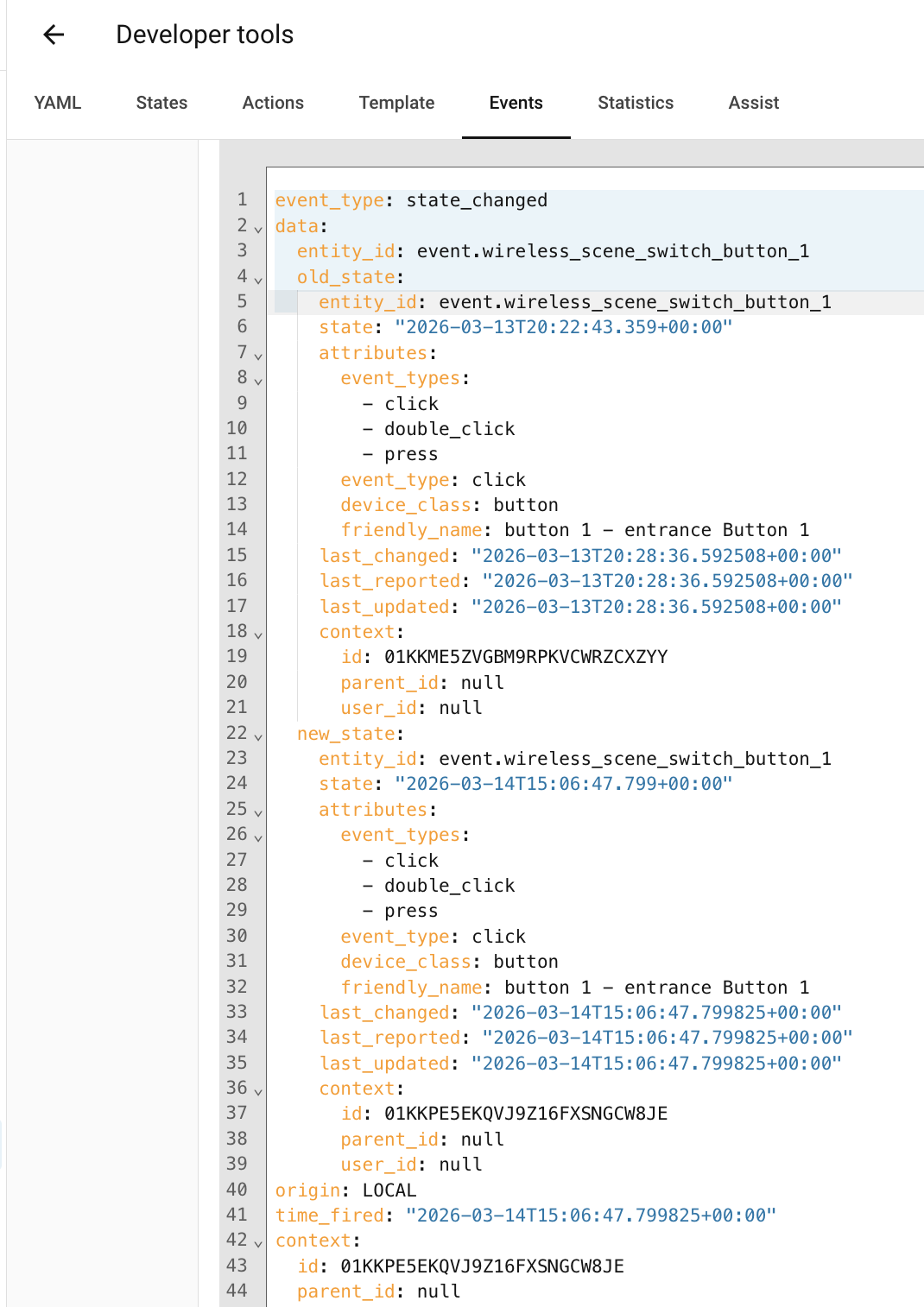

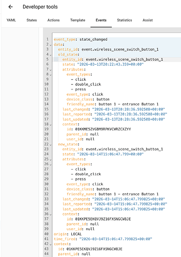

I have a new cheap Tuya Zigbee button connected through a Tuya hub and SmartLife. It has imported into HA and I am seeing events in Developer Tools / Events as shown here
I have not been able to access new_state and old_state in a Condition in an automation, and eventually discovered through the trace that this seems to be the entirety of the event that’s being seen in the automation. I’m only allowed one screen shot so here’s a copy/paste:
trigger: event
event_type: state_changed
event_data:
  entity_id: event.wireless_scene_switch_button_1
As you can see all the data is missing. This is consistent with the error messages the condition produces.
