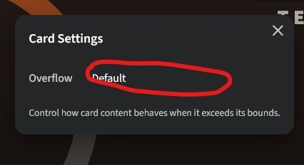

You select the little cog wheel on a card in edit mode, and there is a dropdown in the popup menu there that lets you decide on a card-by-card basis what you want.
Thanks for this that’s perfect.
