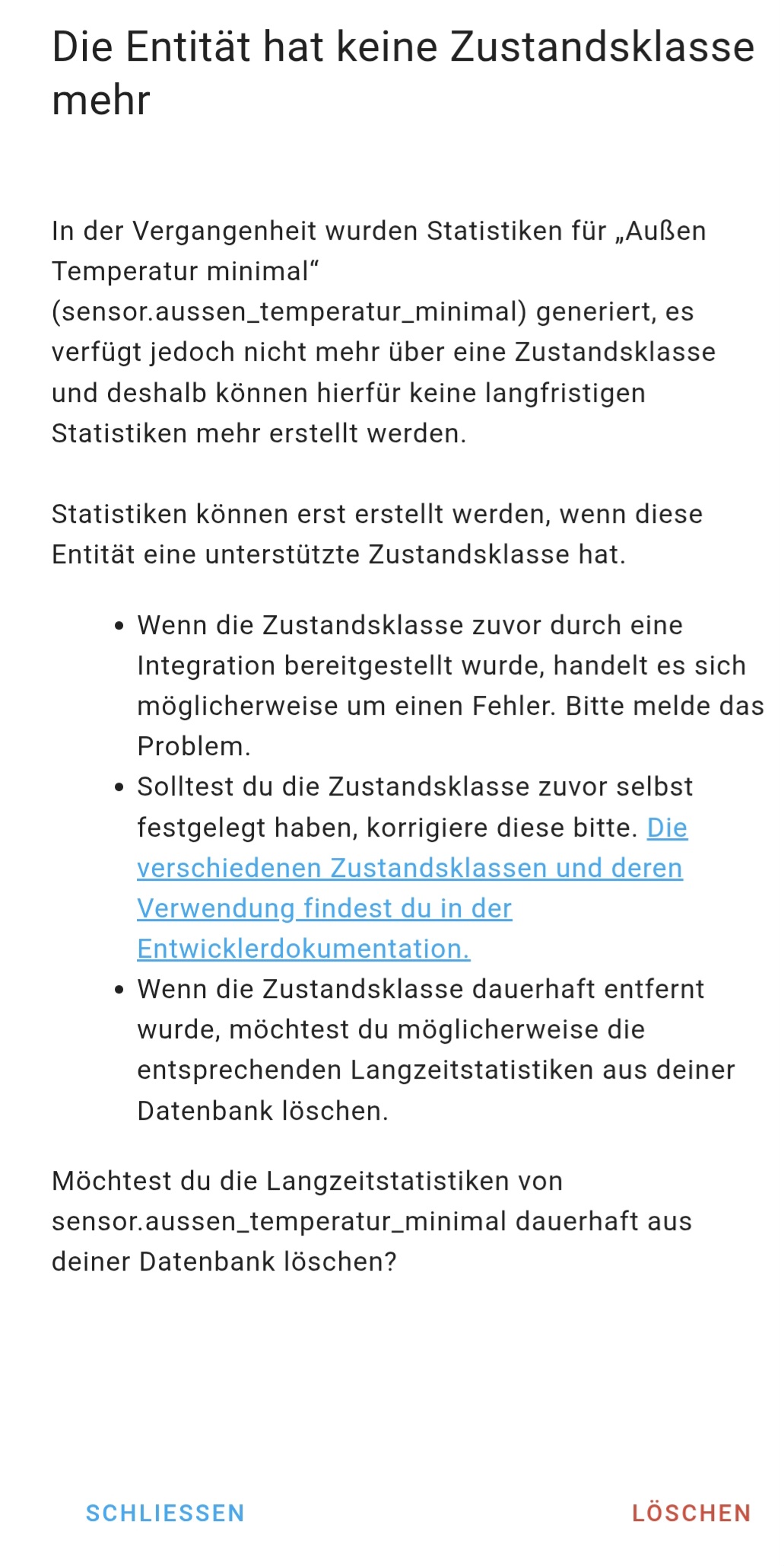

The entity no longer has a state class
I have a Probleme with a sensor.
The entity no longer has a state class.
In the past, statistics for “outside temperature minimal” (sensor.aussen_temperature_minimal) were generated, but it no longer has a state class and therefore no long-term statistics can be created for this purpose.
Statistics are then only stored for 10 days.

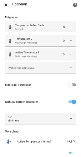

I created a sensor group with min filter.
2x Temperature KlimaLoggPro 1x DS18B20.
Does anyone have any advice on what I can do that the long-term statistics work?

entity_id:
  - sensor.temperatur_schrank_ausen_dach_ds18b20
  - sensor.temperature_7
  - sensor.temperature_8
min_entity_id: sensor.temperature_7
unit_of_measurement: °C
device_class: temperature
icon: mdi:thermometer-check
friendly_name: Außen Temperatur minimal
state_class: measurement

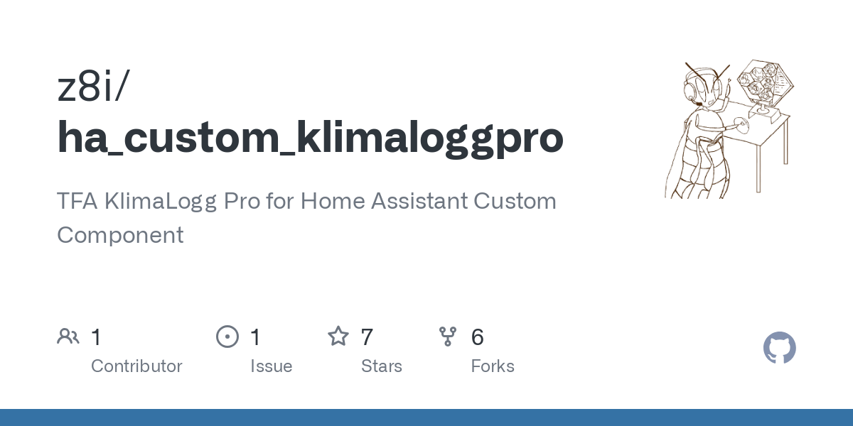

Does not look like there has been any movement on this: The sensors only record 10 days of data · Issue #8 · z8i/ha_custom_klimaloggpro · GitHub
So you will likely have to add the state class manually. See: Home Assistant Core Integration - Home Assistant
EDIT: oh, there’s a fork of the integration lower down in that issue you can use.
